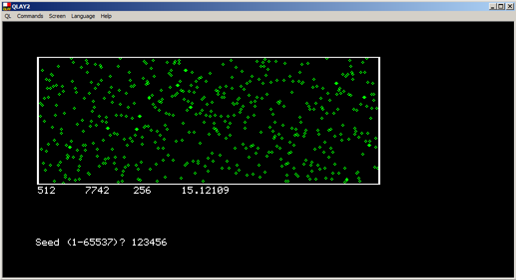

Re: MDV Software Reclamation
Steve,
This was your code:
...and I just rewrote it to:
Lines 280 and 290 in yours is just line 60 and 70 in mine. You pass in the seed in line 340 and normalize (i.e. q=r(q): RETurn q/65537) but most random number generators you can call without a seed as they just keep it global, though they do normalize so I could just change my line 80 to RETurn seed/65537 to get a value between 0 and 1. The two usual function calls are rand() and srand(seed) but on occasion the call is parameterized so it can do some normalization -- i.e. rand(1,10) might return a number between 1 and 10.
I tested it, skipping every 128 sequences, starting at whatever seed, and I didn't see any patterns (I plotted 512 points). It's tough finding a good multiplier for a small 16 bit cycle so that's why I asked where you came up with 8421.
Here is my test code:
And here is the plot it created.

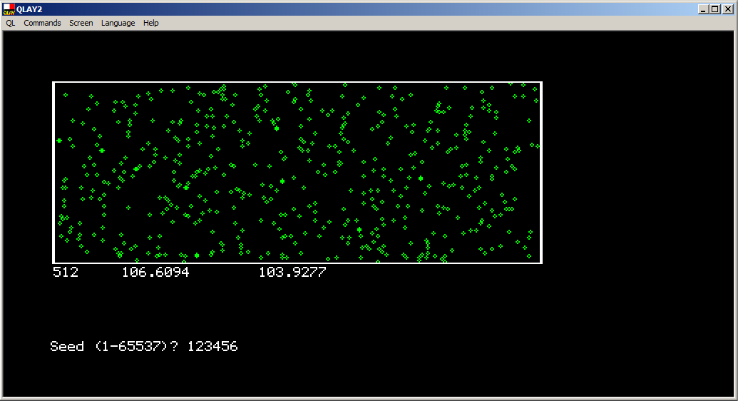

Then using your scatter plot...rewritten for my output:
Similarly distributed:
5 MODE 4: PRINT #0, "Seed (1-65537)? ";: INPUT #0, seed
10 WINDOW #1, 344, 128, 35, 35: SCALE #1, 128, 0, 0: BORDER #1, 1, 7: PAPER #1, 0: INK #1, 7
15 WINDOW #2, 256, 10, 35, 164: PAPER #2, 0: INK #2, 7
20 FOR i = 1 TO 512
25 FOR j = 1 TO 128: skip = myRand
30 pt = myRand: INK #1, 4: CIRCLE #1, i/2, pt/512, 1
35 PRINT #2, i, pt, i/2, pt/512
40 END FOR i
45 STOP
50 DEFine FuNction myRand
60 seed = (seed * 8421 + 1)
70 seed = seed - INT(seed / 65537) * 65537
80 RETurn seed
90 END DEFine
20 FOR i = 1 TO 512
25 x = myRand: y = myRand
30 INK #1, 4: CIRCLE #1, x/256, y/512, 1
35 PRINT #2, i, x/256, y/512
40 END FOR i
45 STOP
80 RETurn seed
90 END DEFine
