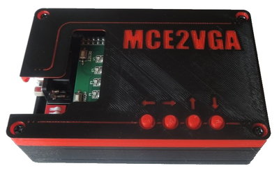

Cristian
Posts: 1024
Location: Veneto
Re: RGB to VGA
Post by Cristian »
I've just found this device I didn't know.
It accepts some kind of RGB input. Probably it's worth investigating...
https://www.serdashop.com/MCE2VGA
