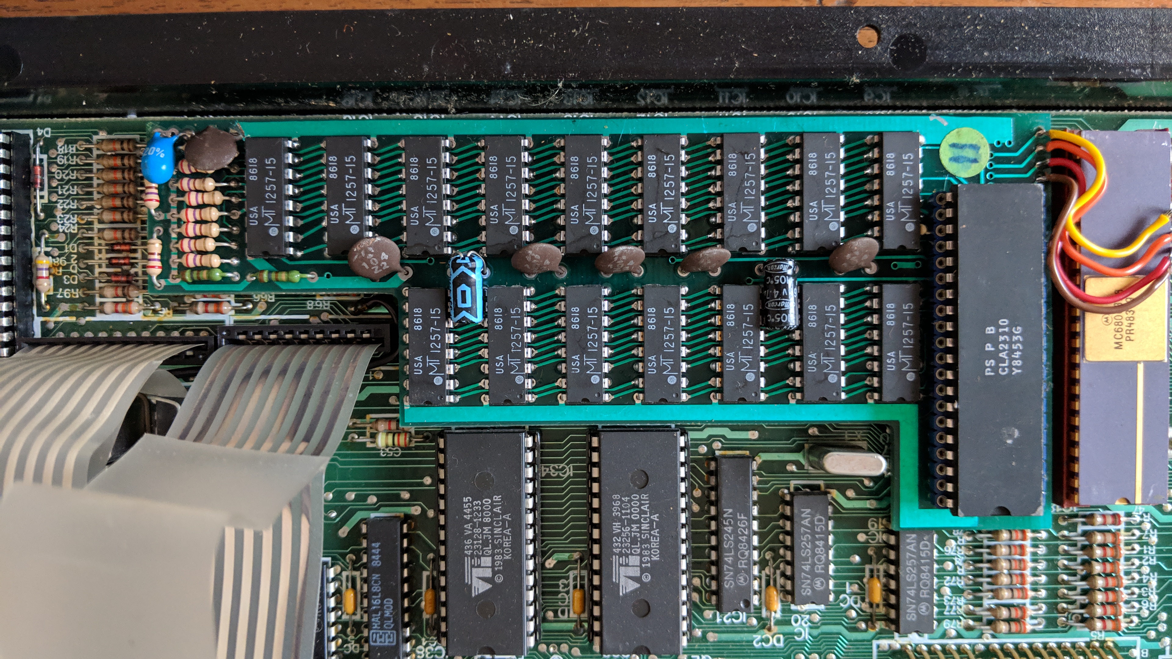

and here is what I presume is the same thing as a slightly more professional version I picked up in another QL just now:

olifink wrote:and here is what I presume is the same thing as a slightly more professional version I picked up in another QL just now:
I used to have such a memory extension from Micro Peripherals, it was only 256K so this must be a different one.
Jan

olifink
Chuggy Microdrive
Posts: 69
Joined: Tue Oct 30, 2018 7:35 pm
Re: Hardware detectives for FrankenQL?
Post by olifink »
martyn_hill wrote:That second internal expansion of Oliver's is certainly a nicely designed and built unit.
I also got the machine going now, must have been a flaky connection somewhere. It is actually a 512K extension and sits on top of the existing RAM.
