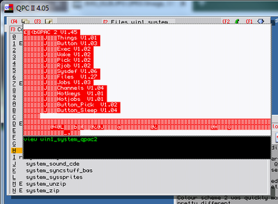

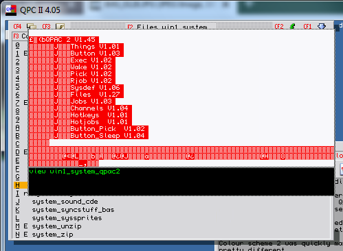

I'm concerned about that screen shot. I would have expected the screen to be full of data.
This is the start of QPAC2 from the QPC2 demo There's about 20 screen fulls.
Where as in the screen shot there are only 3 lines. I know that copying to the scr_ , it will just scroll to the end of the file. But why isn't the screen full?
Re: Installing SMSQ/E on BBQL+gold card
I'm with you, Martin - The provided screenshot looks more like the dump of a directory file than that of a binary to me.
A dump of a working QPac2 (1.08) on my system looks very similar to yours.

I agree that qpac2 may be a directory. The same file in qemulator is a directory for english, french , german version. There is an —>. Where as in bbql gold there isn’t. Could it be the gold card isnt viewing subdirectories. How do you activate that? With the TDI trump clone I saw subdirectories ok
I will see version for smsqe and qpac2 when I can.
