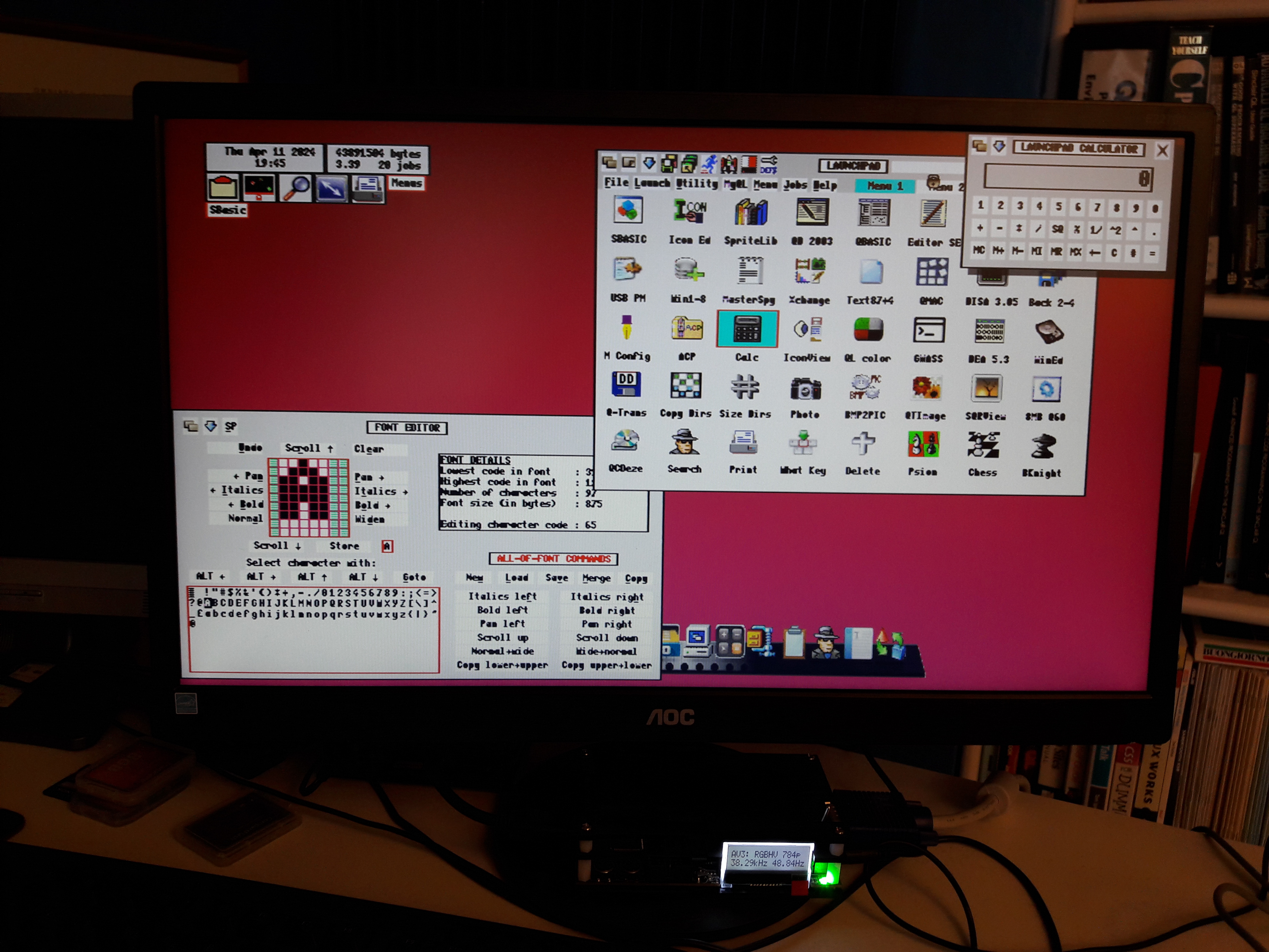

Derek_Stewart wrote: Sun Mar 24, 2024 10:48 pm There is a problem with the Q60 VGA video output, which does not give a clear video output in 1024x512 HiColour mode, on a modern LCD monitor
This is such a tragedy. At design time, it was simply not foreseeable that flatscreen monitors would no longer have multisync capabilities.
I have spent countless hours on this, but there is no fully satisfying solution.
A clear video picture is possible by a replacement PLD that generates 1024x768 resolution. But it keeps the lower part of the screen black and displays only 1024x512 in the upper area.
Derek_Stewart wrote: Sun Mar 24, 2024 10:48 pm I am looking into a ways of video signal conditioning to to suit moden LCD monitors.
It has been said that OSSC converters can provide that, if they are well tuned. But one has to be careful about the various variants.
Also I find them clumsy and expensive.
The OSSC is a very comprehensive open source video converter, but is hard to make, the pre-made converter boards are quite expensive.
I might have a go at making one.
I have tried OSSC and gbs-control on Q60 and I could not find a setting on either that would successfully display the full Q60 screen!

XorA wrote: Thu Apr 11, 2024 12:35 pm
Thierry's settings appear to give full Q60 display http://qdos.free.fr/monitors.html (see http://qdos.free.fr/files/OSSC.txt)
Posts: 2542
Re: Q40/Q60
ones' complement wrote: Thu Apr 11, 2024 12:49 pm Thierry's settings appear to give full Q60 display http://qdos.free.fr/monitors.html (see http://qdos.free.fr/files/OSSC.txt)
Many thanks for the link. Curious if someone gets it to work on an up-to-date OSSC.

Peter wrote : Curious if someone gets it to work on an up-to-date OSSC.
Hi Peter, I bought an OSSC Kaico v1.6 scan doubler from Amazon for my Q60 during lockdown. Yes it was a bit pricey but I wasn't able to spend on much else, and if you think about the price of the scan doubler to what I paid for the Q60 20 or so years ago which I think if my memory is correct was around £700 it doesn't seem unreasonable to buy one to keep the Q60 going. I have used Thierry's settings with a cheap flat screen and while not perfect it is definitely usable.
Posts: 2542
Re: Q40/Q60
Artificer wrote: Thu Apr 11, 2024 7:59 pm I have used Thierry's settings with a cheap flat screen and while not perfect it is definitely usable.
Many thanks for the info and for posting the pics. Not sure I would be satisfied with the OSSC.

Peter wrote: Thu Apr 11, 2024 8:17 pm <> Not sure I would be satisfied with the OSSC.
Same here. If the photos are an accurate representation it is not something I could work with. Sorry.
