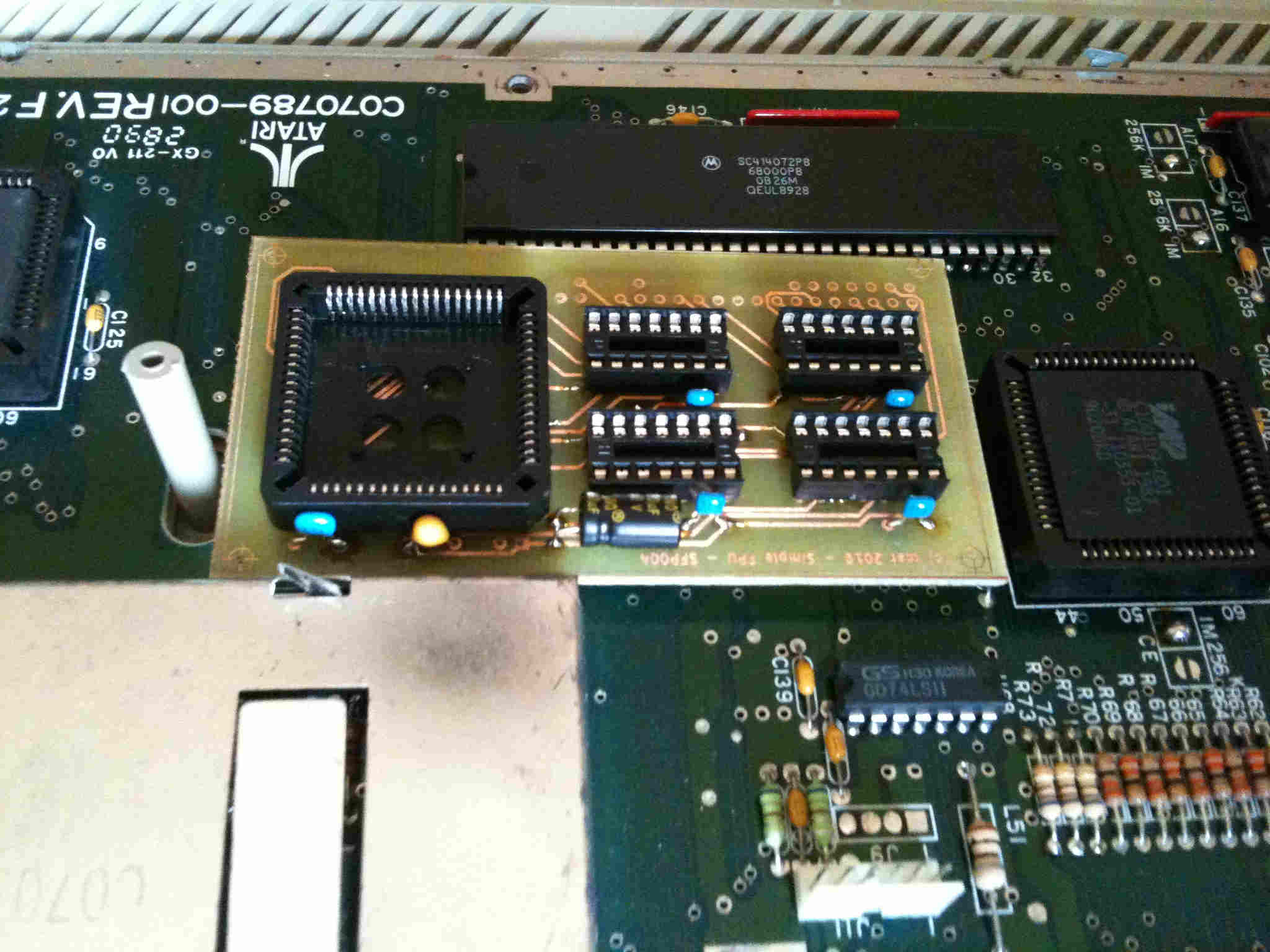

No idea it will work in the end, but this is how it may fit inside my STFM machine. P1 should connect to CPU pins using ribbons, at least that is the idea so far, but there is RP7 red component getting in the way on one CPU side!!! Inevitably the ribbon will partly cover CPU from top, any precautions here, to allow CPU dicipate its heat properly?

Just be aware that different STF(M) revisions have the components in different locations.
This may be a useful resource: https://www.exxoshost.co.uk/forum/viewforum.php?f=41
Re: 74HCxx vs 74LSxx
Shouldn't be a problem, the 68k CPU does not dissipate that much heat so hat being partially occluded by a ribbon cable would be a big problem.

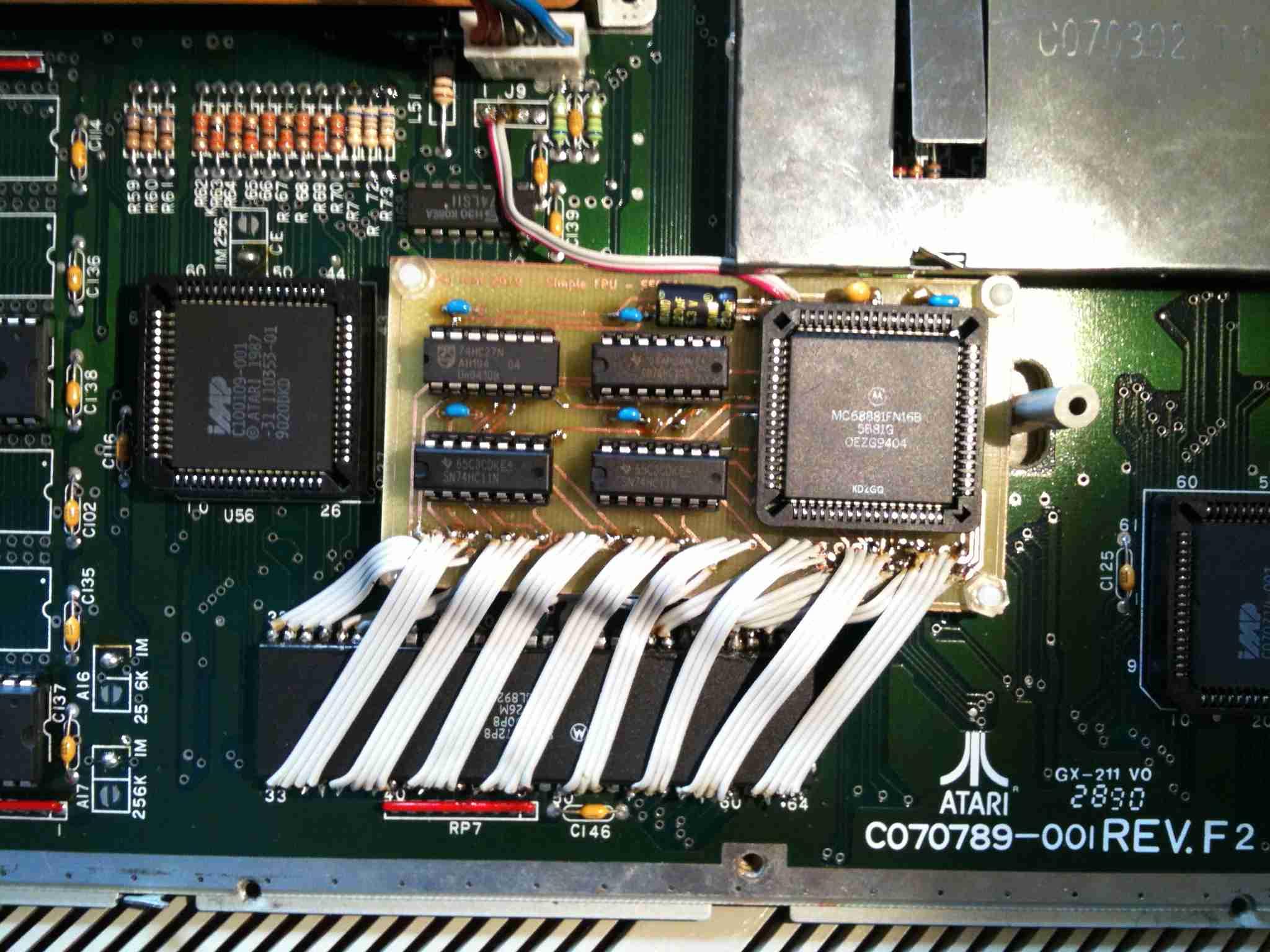

I have only a simple `pistol' soldering iron, and I am not very skilfull with it. This is what I have, ICs populated in the sockets, VCC/GND sourced around PSU connector.
GEM-BENCH reports some 1400% on FPU math test, while SYSINFO reports NO-COPROCESSOR fitted.
What does it actually mean?

As my soldering is not very neat, I am no way sure I had it functional. I run this simple test that was coded by a German ATARI branch years ago.
This may be an indication, it hopefully works?
