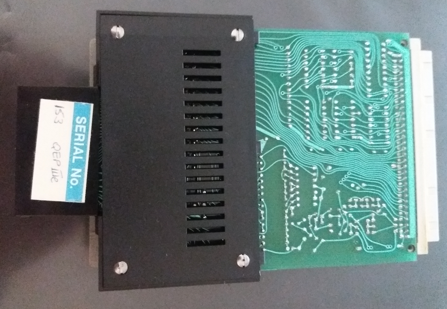

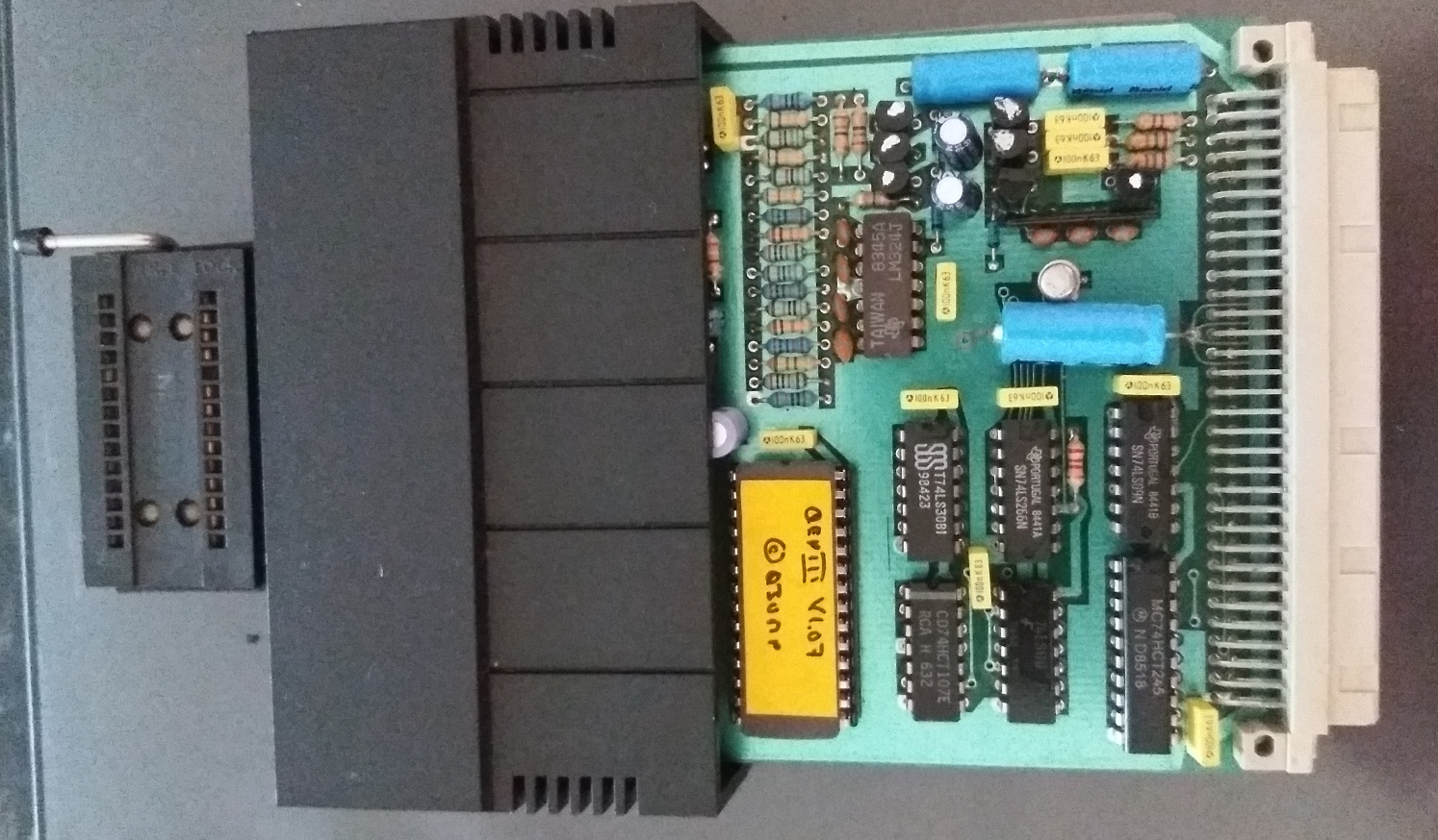

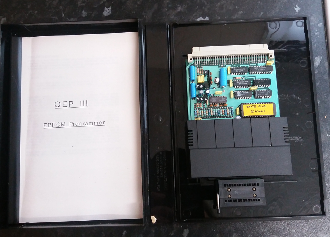

I have got a QEPIII Eprom Programmer from Ebay, I have not tried it yet, but here are some photographs.
QEPIII Front Box
QEPIII Front Box
QEPIII Front Box
QEPIII Front Box
QEPIII Boxed
QEPIII Boxed
QEPIII Top
QEPIII Top
QEPIII Back
QEPIII Back
I will dig out a QL and post pictures of the programming of eproms.

Interesting shape of lines on the Eprommer PCB. I wonder whether they were made by flexible adhesive tape or even painted...
