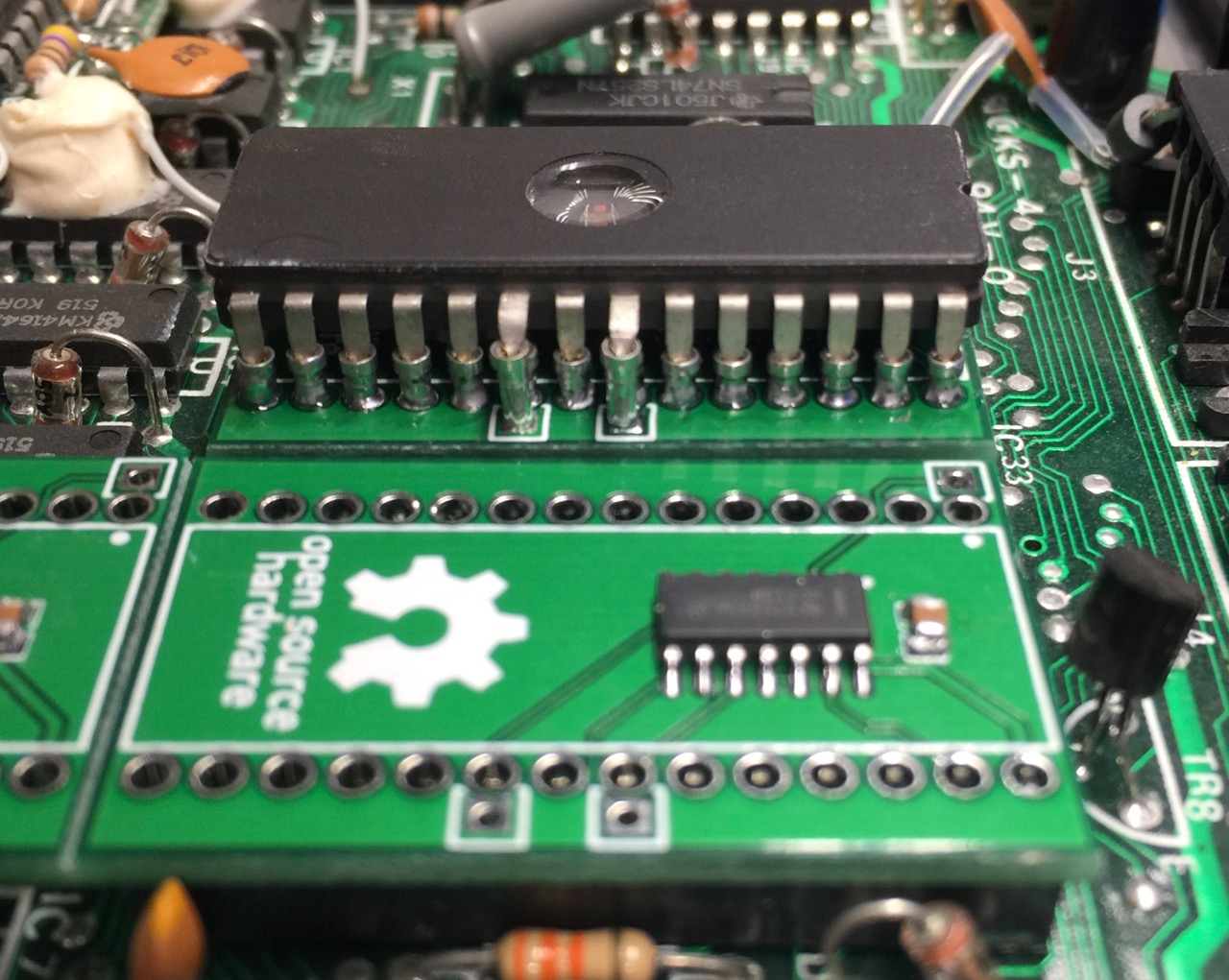

The ROMs on the QL are quite like EPROMs, except the /OE signal is inverted. On one it is active high, on the other active low. So Minerva on an EPROM comes on a little carrier board with a 7400 or similar to invert the ROMOE signal.
Minerva bare board, Minerva EPROM right behind it.

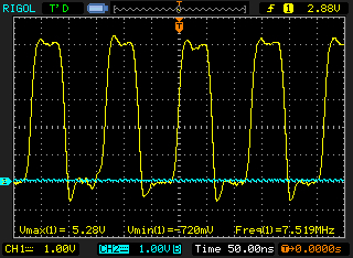

Check X1 and X2 are both making 15 MHZ, and you see 7.5MHz on CLKCPU (8301 pin 7, CPU pin 34)
Reference clock pic:
7.5MHz clock.
7.5MHz clock.

Dave wrote:The ROMs on the QL are quite like EPROMs, except the /OE signal is inverted. On one it is active high, on the other active low. So Minerva on an EPROM comes on a little carrier board with a 7400 or similar to invert the ROMOE signal.
Thank you for the information and picture. It looks quite easy to install, and very convenient.
