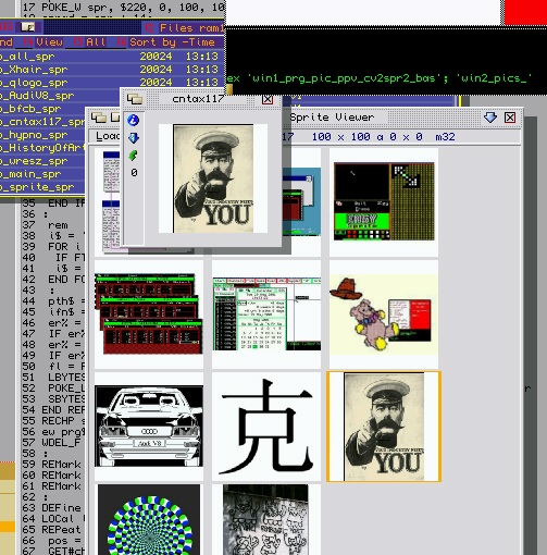

To put some meat on the bone, here is an example of a POC "thumbnail" viewer.
Its quite rudimentary and uses my old sprite viewing program to display the
results. The conversion of the various pictures; jpg, img (Atari), pic, etc to
100x100 pix sprites went quite quickly. In practice, one would retain the
thumbnails til next visiting the same directory (updating and deleting), in which
case loading them is very fast indeed.
