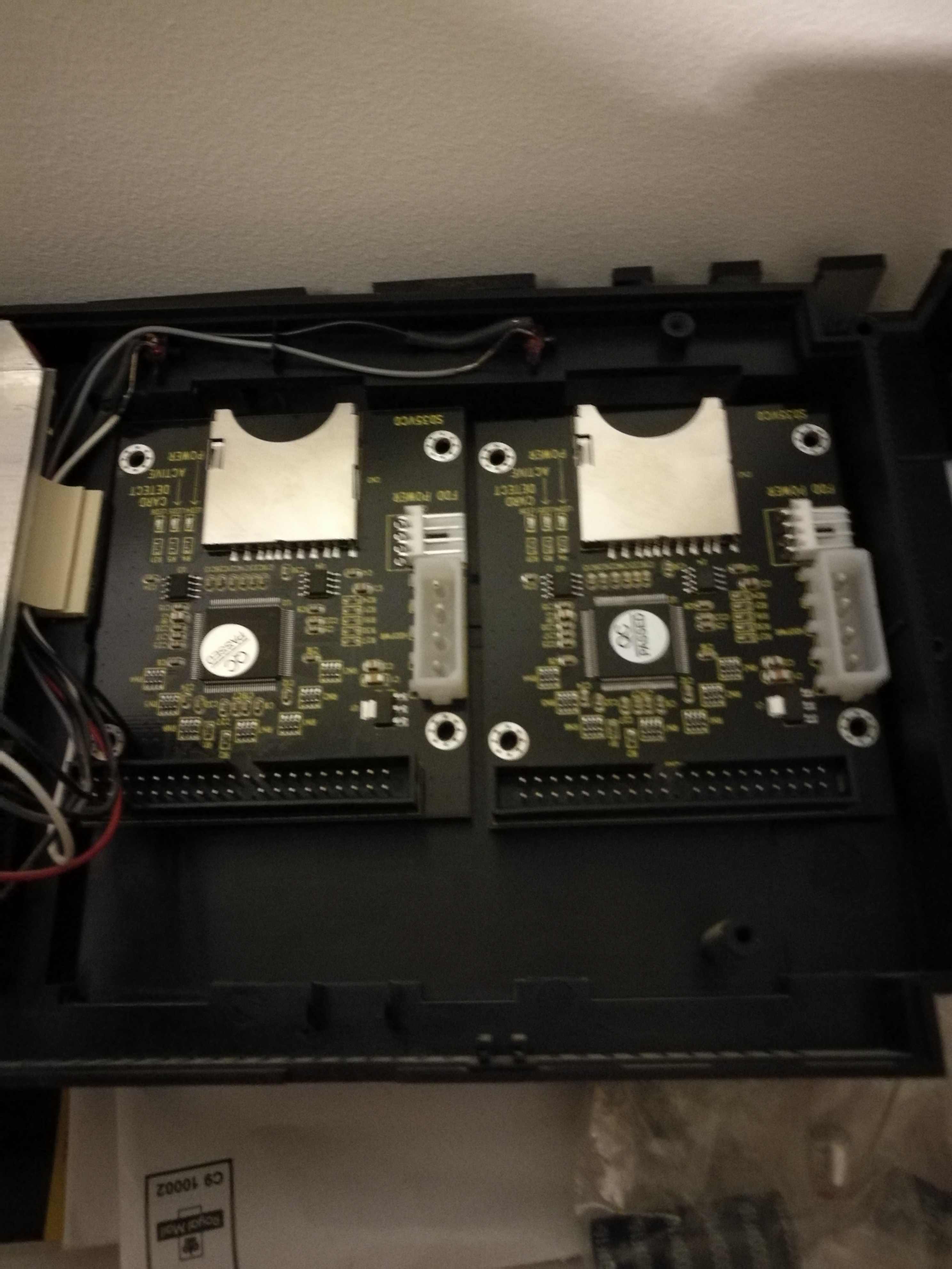

2 SD card adaptors fit nicely in the top of the QL case, the SD card slot fits quite well in the Microdrive slot. The only down side is the SD card would be upside down.
Posts: 2812
Re: a DIY home build project...
If you replace those IDE connectors with right angle connectors, they'll go the right way up too.
Posts: 1574
I did wonder about that too, but the only way they can really fit is if I remove the power connectors and 40 way IDE connector and mount them on the other side. I am happy to live with them upside down, as it's a lot less work...

Dave wrote:You'd just need to remove the HD power connector, because it's duplicated in the floppy power connector.
There is possibly only a few mm between the pcb and upper case, so all the large connectors would need to be removed - as you say, I only need one power connector, but even the 4 pin floppy power connector is too deep for the SD cards to align in the slot correctly. The big 40 way IDE will definitely have to come off and go the other side.
It is do-able.
