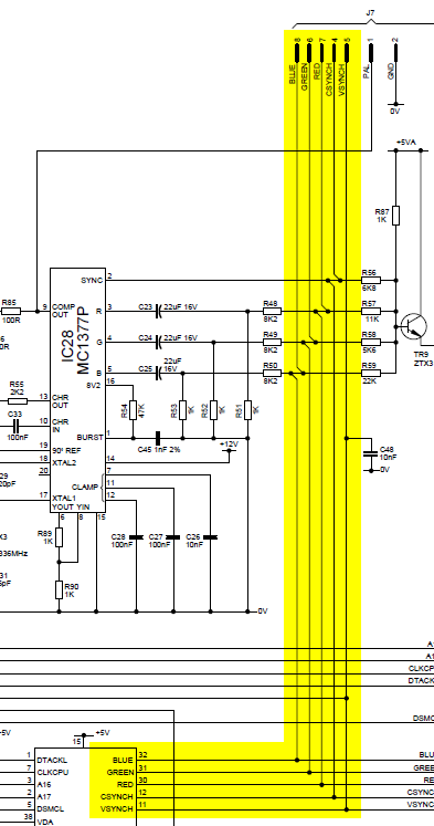

My gut feeling is that these video ULA's are connected directly to the outside world on the 8 pin connector - so if someone has got a badly wired plug or cable, who knows what damage can ensue.

Pr0f wrote:My gut feeling is that these video ULA's are connected directly to the outside world on the 8 pin connector - so if someone has got a badly wired plug or cable, who knows what damage can ensue.
Indeed, there is zero protection on the TTL video outputs from the ZX8301 ULA (see annotated schematic). Whether the loading from the 8-pin connection or some other interaction from defective PAL components/MC-1377 could render the observed behaviour is unclear, but a possibility.
