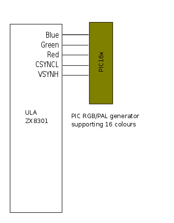

All very good, but so far beyond my skills and capabilities. `HDL' I only have heard of in connection with `FPGA' boards, seems a language to setup h/w logic, with a steep learning curve for non h/w talents like me.

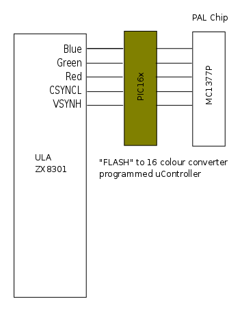

I was thinking of a simple logic in the `PIC' controller that would sniff on R-G-B, and whenever it decoded the 'FLASH' signal it would calculate extra colours. The logic could be dis/enabled by writing to a specific ROM address twice in succession.

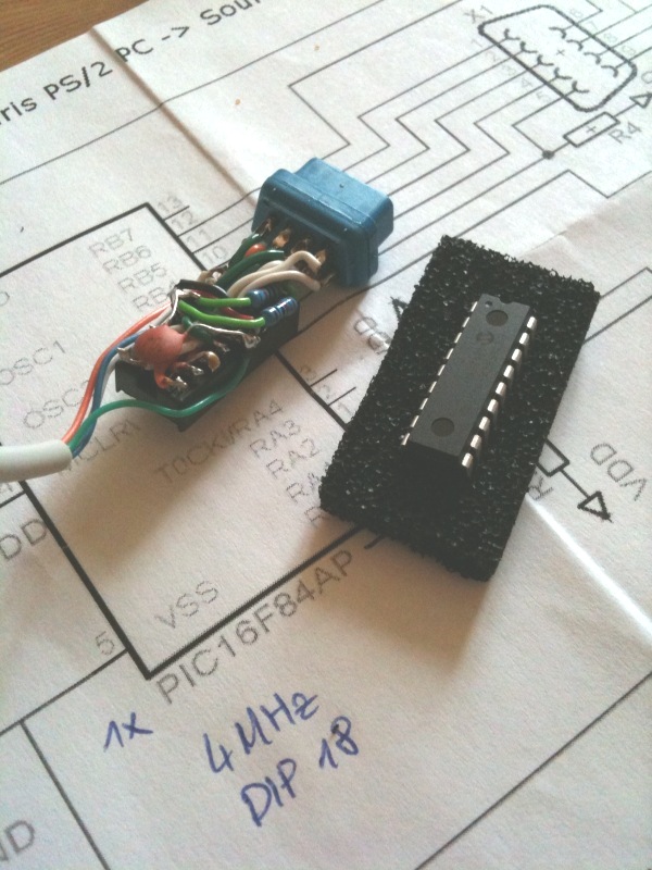

My only venture so far with `PIC' was this, but I merely copied someone else's design. I plan to build a simple `PIC' programmer, that could in theory be attached to QL's SER{1,2} ports and programmed right from there. Tomas

I was hoping to device something slightly different, while keeping ZX8301 in place, but supplementing its logic [A] or replacing PAL chip . Currently having no knowledge of TV/RGB picture generation, so I hope the idea not being totally silly?
[A] Tomas

on this end of the 8301 there is not enough information to do what you intend to do - The PIC would see pixels rushing by at the sync rate - It would also see what colour the pixel would be, bit no longer why. There'd be no way to decide whether a pixel is deliberately red or red because it's currently flashing between red and some other color, for example. That's what was meant with the "missing pin". The FLASH information is lost here.
The FLASH bit sits in the screen memory and simply switches the 8301 to output another color between alternating FLASH bits, switching this behavior on and of in the FLASH interval. You'd have to look onto the data bus side of the 8301.

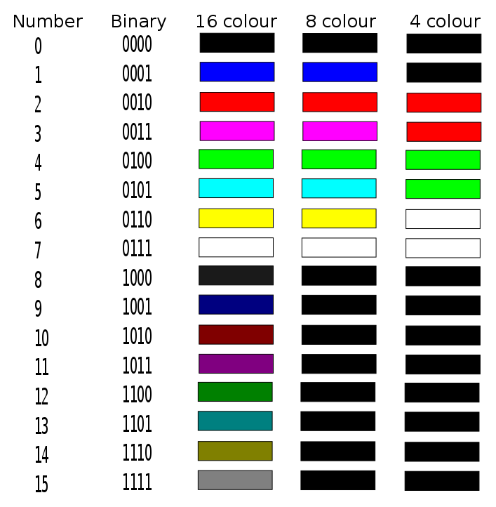

Is the PAL chip capable even of more colours, GOLD/TRUP cards bypass ZX8301+PAL chip with its own circuitry?
I think we probably need to keep stipple colours, which is a unique feature giving possibility of colour mixing, patterns, and dithering.
