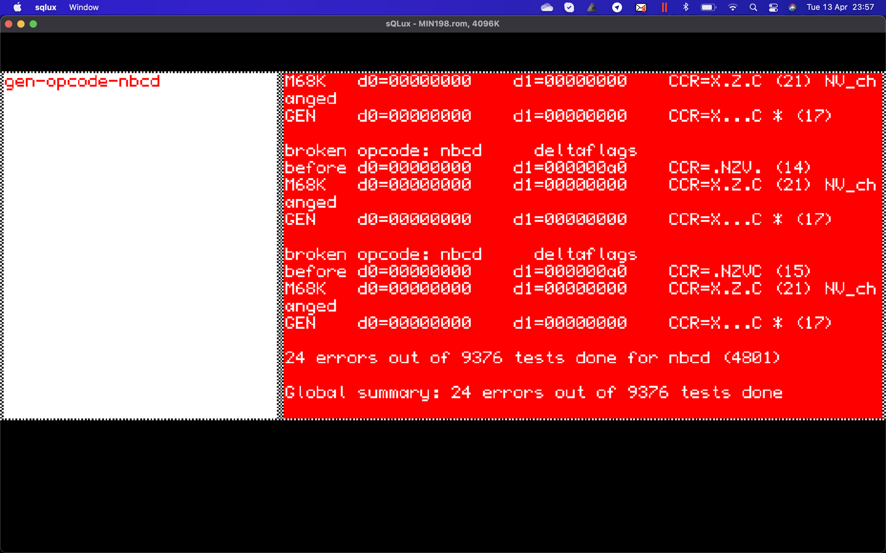

	negative = r < 0 ? 1 : 0;
has got me a lot nearer to success
Only 24 tests to go.

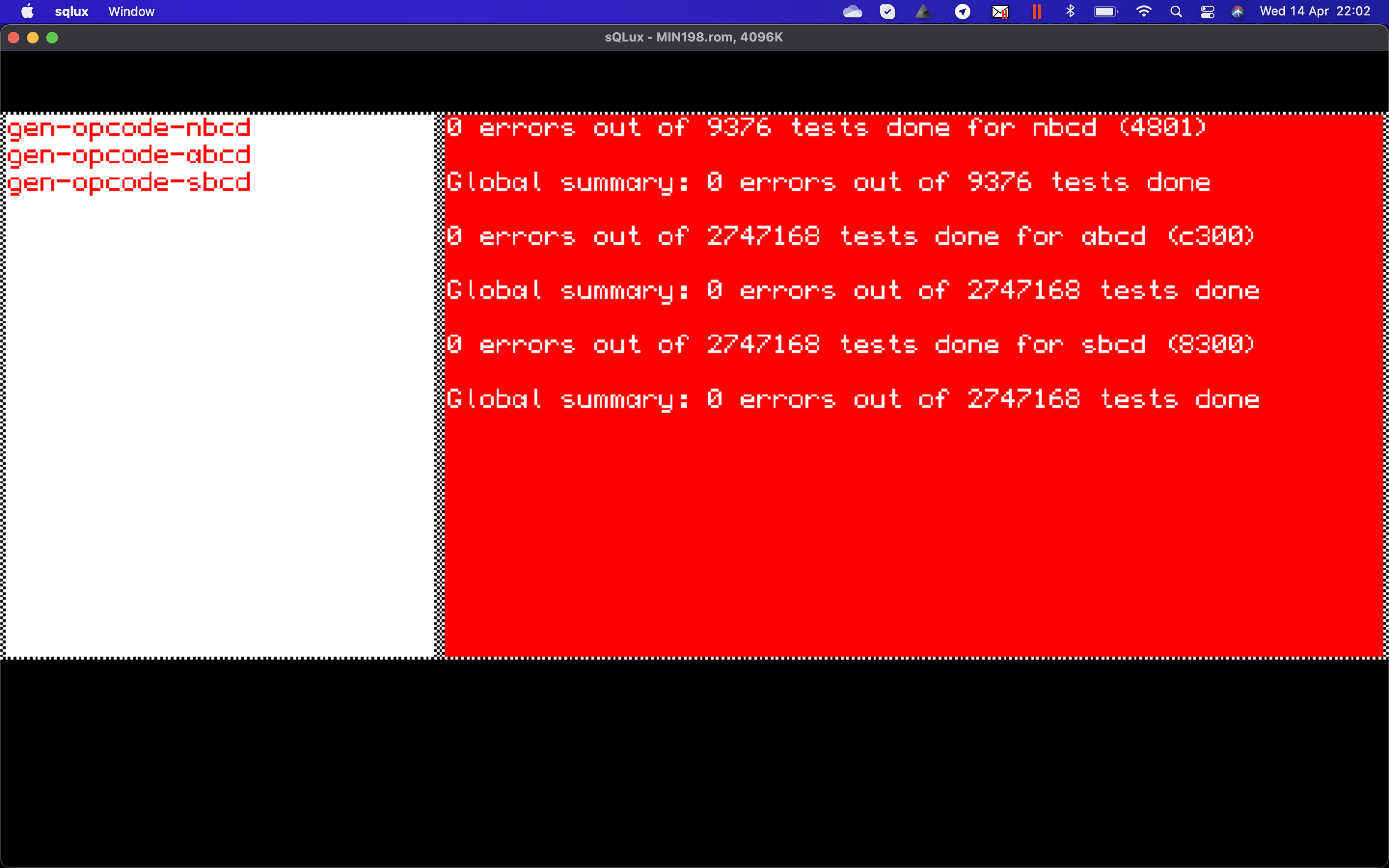

Posts: 1694
Re: 68000 instruction test suite QL
And reading my own post noticed the mistake (using the intermediate result for zero not the final)

and all tests pass.

Posts: 1694
And thanks to the guidance of Marcel the master.
