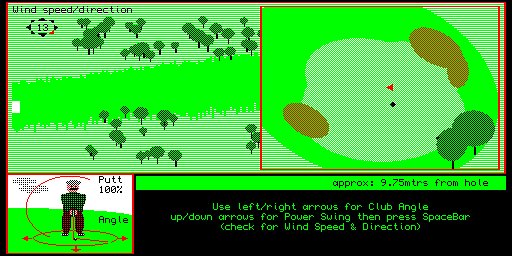

Derek appreciate your time spent and offer to help - but more confused the QBGolf_2106_12 I uploaded in both instances has line 215 as DEFine PROCedure Init_golfer, unless you are renumbering the lines can you give me the full line.
Compatibility with such as SMSQ/E is a world I haven’t yet explored so I can’t answer your question.
I have it working with the QL2k emulator (clock multiplier set at 500) running under windows 7 also under windows 10 on a Linx 10. I have tried it with the Q-emulator unregistered version on both win 7 and win 10. Very slow but the code does work.

your golf game is very nice! After a LRUN in my original QL it gives a "Bad name" error, but after a RUN it starts normally.
Yesterday I had been playing for about an hour

Thanks Cristian that’s good to know how’s the speed!
Bad name error is the devicename$ not relevant to your setup check below.
Update – OK a first for me I downloaded and have a copy of the SMSQmulator up and running with windows 7.
LRUN QBGolf_2016_12, appears to be working.
Problem(1)
Line 260 WINDOW#ch,90,60,412,gy:Green
I stop the program before this line executed and all appears OK.
I stop the program before executing PROC Green and I lose the top of my main screen?
ie. The headings are lost Wind speed/direction indicator, the hole number, length, par.
Problem(2)
The when the ball lands in a bunker for some reason running under the SMSQ it is not recognised?
Plus this is an error on my part with regards to water hazards:
Line 296 IF Gf(h,8)<= S/be IF Gf(h,7)<= & Line 298 IF Gf(h,8)=5 S/be IF Gf(h,7)=5
Not to forget Line 5 alter to your device name for LOAD & SAVE PROC’s
Well its getting busy with Christmas and all, so I guess any further work will wait until the NEW YEAR!
Thanks again Derek for getting me to try out the SMSQmulator...

The global speed (on my normal QL, without Goldacrd) is acceptable. The only critical point is the swing preparing and animation.qbits wrote:Thanks Cristian that’s good to know how’s the speed!
In any case the game is nice and playable

I have only now discovered your golf masterpiece. It is a great prog, not being a golfer gives me feeling of a real play.
I dared to touch your code a little, hope you may not mind.
[a] I converted CRLF line ending to be LF only
I renumbered the code
[c] I changed these lines
Setting device to mdv2_
Sets all black background, WTV removed, 165 line added
EDIT: ch#2 set to console to allow program editing
Resolves problem with `out of range'
EDIT
Golf_close PROC: WTV,PAUSE removed, STOP added
I would not know what to do with water hazard yet.
Attaching _bas after the above mods.
EDIT _bas updated Resulting in this, sincerely hoping that was your intention. Cheers
Tom
