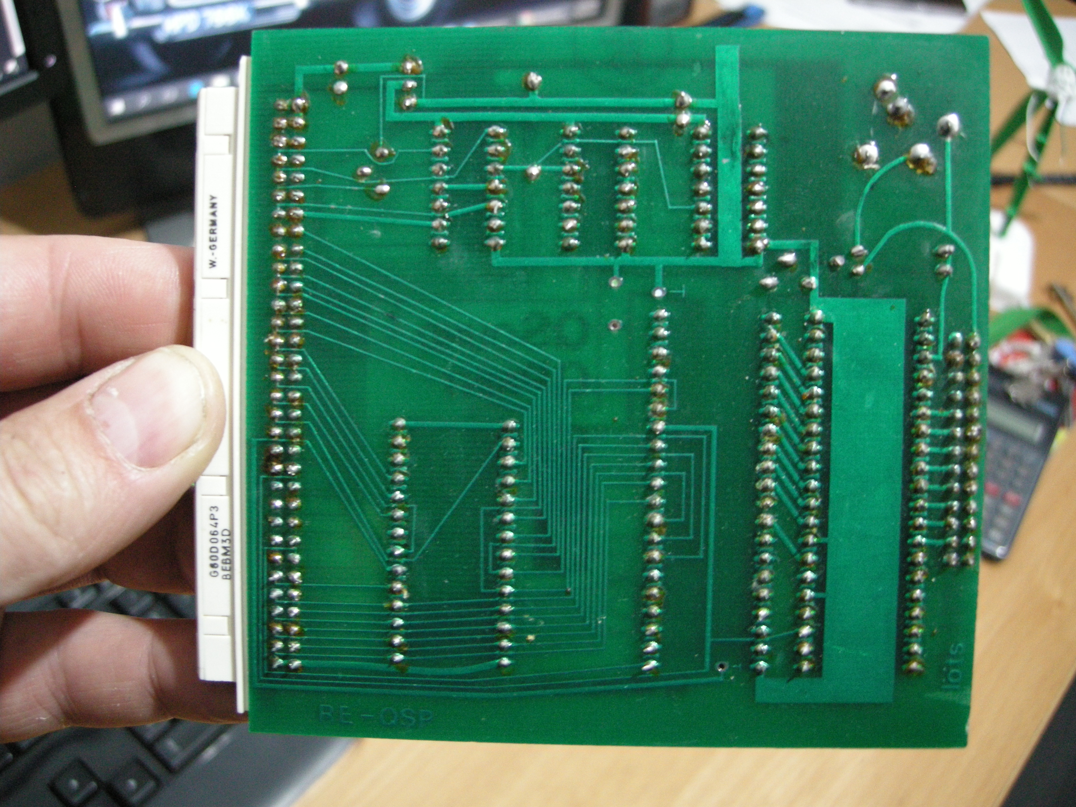

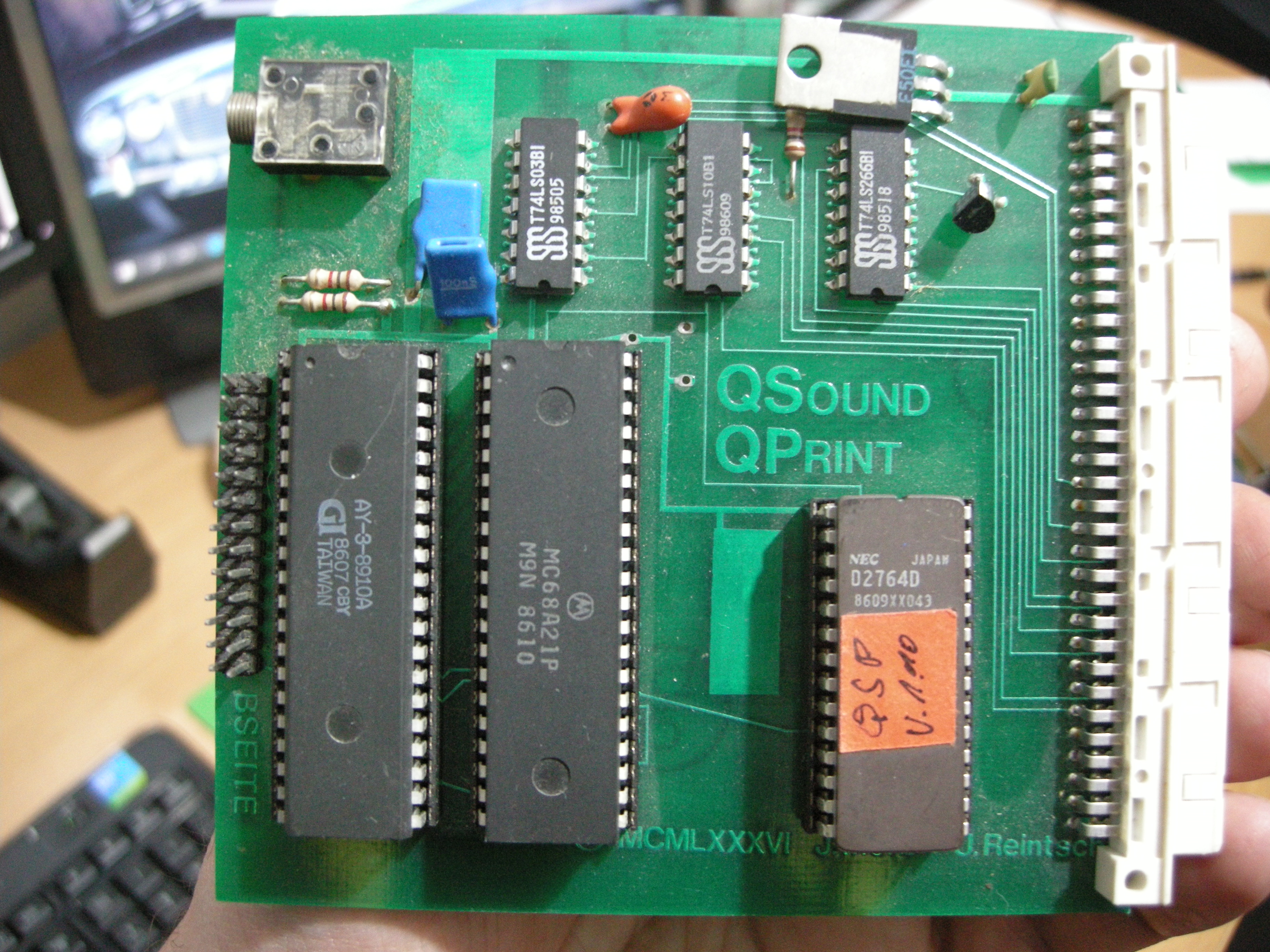

I have seen that somebody bought a QSOUND interface from TTurner35 in michigan via Ebay on 20.12.2016.
Is the buyer here somewhere and willing to contact me?
If anybody else has a QSOUND, no matter if working or not, I would like to borrow it for a short period of time, maybe two weeks, in order to take the schematic and read the ROM content.
Kind regards
Paul
Kind regards
Paul
Re: QSound and QPrint Interface
I have purchased the QSound/QPrint interface. I will be happy to assist.
QL addict since 1986...
