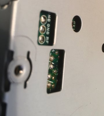

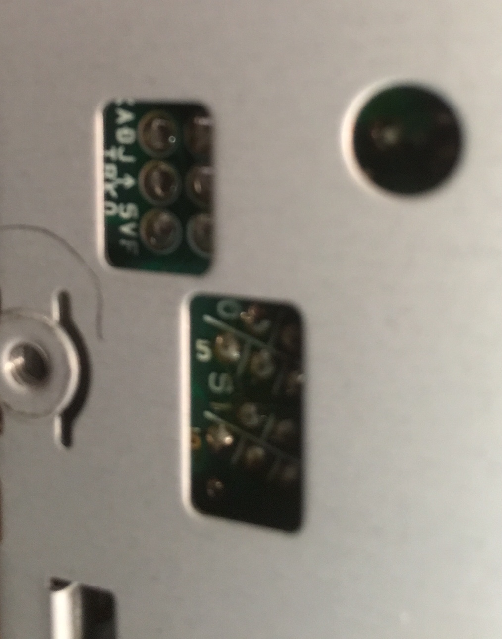

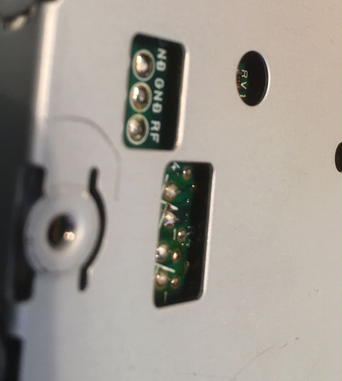

Hi Mark, they're both Sony MPF920s, dated July 2009 although given how cheap you can get 'standard' PC floppies on eBay I'm not above buying a brace of something else if that would make life easier.
There are no jumpers but a couple of visible solder pads with some circuit board marking - I've attached a couple of poor snaps below - I'll do a proper google for the drive and any documentation tomorrow night.

At least some Sony MPF920 drives can be modified (there are various different variations of these drives). I'm mobile at the moment. But may be able to add more info later.

I opened up one of the Sony drives, found the zero-ohm 'jumper' that was 'drive select 1', removed it and soldered-in a tiny tiny jumper wire to bridge 'drive select 0'.
