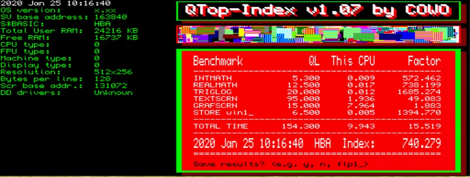

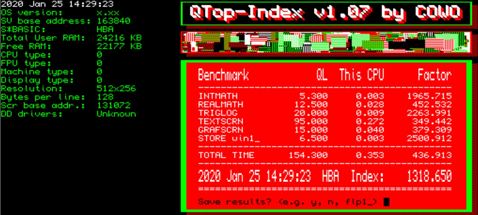

Apropos QPC, on my i7 laptop I'm finding that the results are very inconsistent. One thing is certain though; the GRAPHSCRN part is very very slow in high colour. It shows around 8 seconds, or a factor of approx 1.8 compared to a standard QL, while in 4 colour mode at QL resolution or slightly higher (640x400 etc.) it shows approx 0.04 seconds or a factor of 380. It also occasionally shows negative timings, which is weird.
At QL colours and resolution I have seen results up to approx 1800x QL speed, but it can also be much lower, for whatever reason.
It also seems to report a 512x256 resolution irrespective of which resolution it is actually running on.
D.

daniel_baum wrote:Apropos QPC, on my i7 laptop I'm finding that the results are very inconsistent. One thing is certain though; the GRAPHSCRN part is very very slow in high colour. It shows around 8 seconds, or a factor of approx 1.8 compared to a standard QL, while in 4 colour mode at QL resolution or slightly higher (640x400 etc.) it shows approx 0.04 seconds or a factor of 380. It also occasionally shows negative timings, which is weird.
D.

No, just regular Windows 10. It's actually a powerful laptop with an Nvidia 3D graphics card, although QPC of course doesn't utilise it. I've never seen any sign of graphic slowdowns before.
D.
