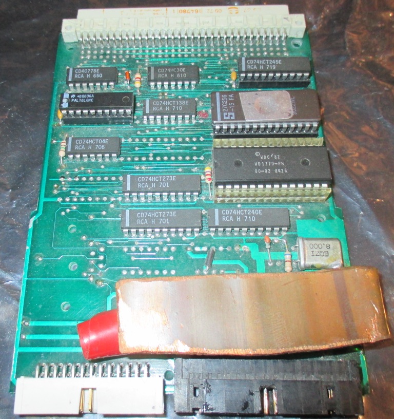

Hi Dave,
I was going to ask how connect the mouse connections, but the files that Dilwyn recommended, Keith Mitchell has already done the hard work and details the changes to be made for the Mouse connections.
The port next to the Floppy disk is a Parallel Port as Rich indicated.
I notice that there are a twin set of soldered in points next to the QL Expansion connector:
Sandy Super Q Board Mouse Issue 3 Top Con.jpg (51.88 KiB) Viewed 4156 times
Can a daughter board for a memory expansion be fitted there?

I also own a super Q Board mouse Issue 3. It was modified years ago.
Is that modification necessary/good or not?
A memory expansion for the board would be great!

You can clean out the holes and put in a socket strip to create a riser for a memory card or any other card within the power limits and space limits of the QL.
Adding the mouse option is all TTL logic plus one programmed PAL as I recall. It also had a different EPROM.

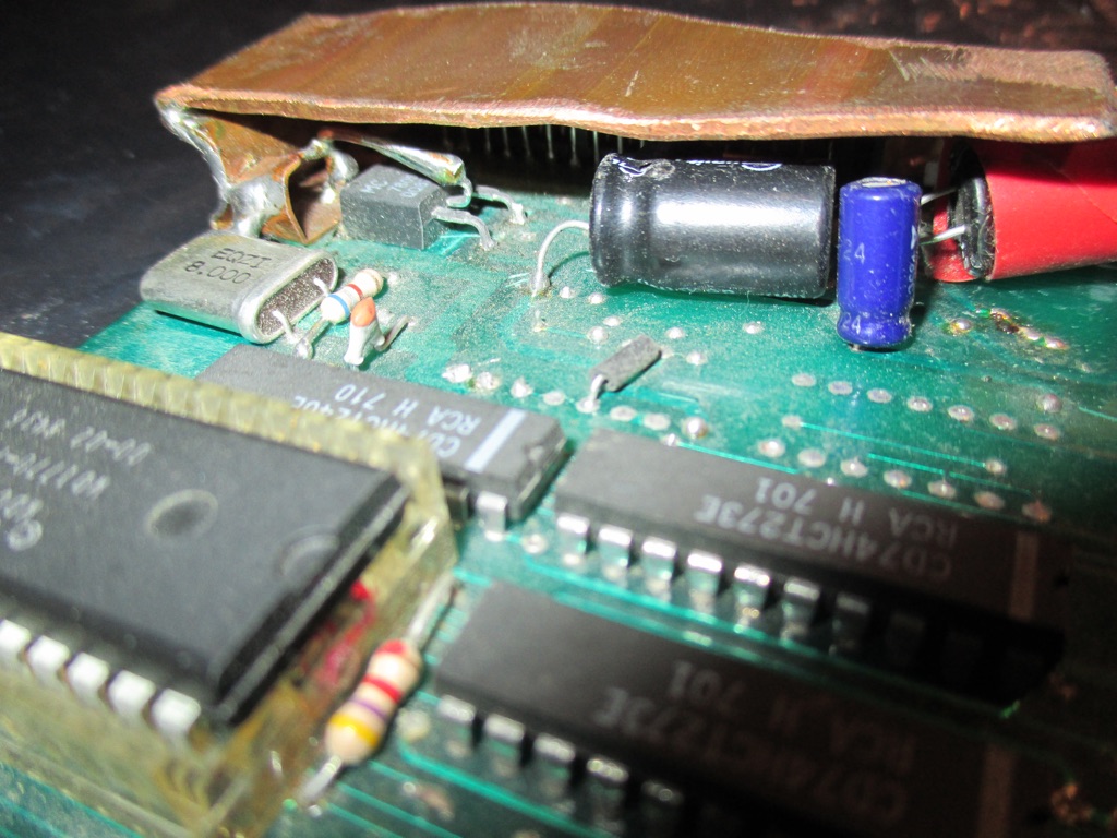

That looks like the kind of upgrade I would do, is that heatsink some squashed copper plumbing pipe? :lol:

Yeah, the guy I got my QL Hardware from tried to to build everything
"for the everlasting kingdom" 8-)
