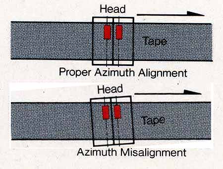

Azimuth is this context refers to the playback/record gap in the head being perpendicular to the tape travel. This gives the best possible frequency response and also means that cartridges recorded on other drives will play back correctly. On audio cassette machines the adjustment is performed by adjusting a screw which raises or lowers one side of the head thus changing the angle to the tape as it passes over the head. The Microdrive is much the same except the the azimuth setting is factory adjusted. To ensure that the heads are calibrated they adjust the 'feet' to sit squarely on the chassis when it is set right. The front dimensions are critical and as mentioned there isn't a great deal of leeway for error if at least one of the rear feet are also seated.

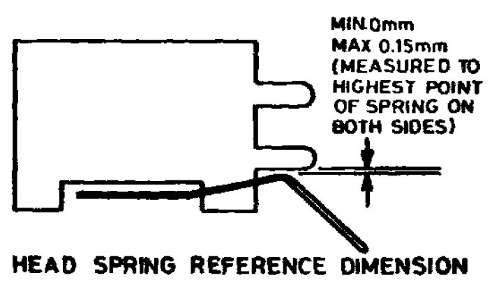

Here's a side view from the Sinclair IF-1 and Microdrive service manual giving a better view of the feet than I provided earlier. Cheers,

This picture shows a situation of one of the MDs I have at the moment for tests.
I am just learning Inkscape, so not a perfect drawing, but I hope it captures the idea.
Can you please advise how to go about the head reseating, as there are solders keeping the head tilted up from the head board.
Many thanks so far.
Tomas

Re: Microdrive Motor Adjustment
Hi Tomas,
The diagram is great. Haven't used Inkscape myself but do use Google Sketchup.
A few questions.
How does the drive perform?
If you have an oscilloscope what waveforms do you see on each data channel?
Does the drive run smoothly?
If the drive otherwise seems OK then there is likely no need to adjust anything. If it has problems then would pay to eliminate as many other possible causes before changing the head seating.
If you find that nothing else seems to be the issue then you can desolder the head pins from the head board and resolder them wih the head seated as previously described.
Charles
Hi Tomas,
Unfortunately if the head has significant wear then reseating will probably make performance worse as the tape would not tend to run flat against the head. Having the head in the correct position helps with even wearing and is easier on the tape in the long run. Badly worn heads will led to a drop in high freequency performance as the head can gap widen (dependent on the head construction). In this case I would expect the lower channel to be more prone to drop outs but only an oscilloscope can shed some light on this.
I wouldn't recommend trying to bend the pins without desoldering the head. It would require signifianct force which could lead to other damage. Given the wear on the head I would probably leave it as it is if it is working otherwise you'll need an oscilloscope to better fault find any problems.
