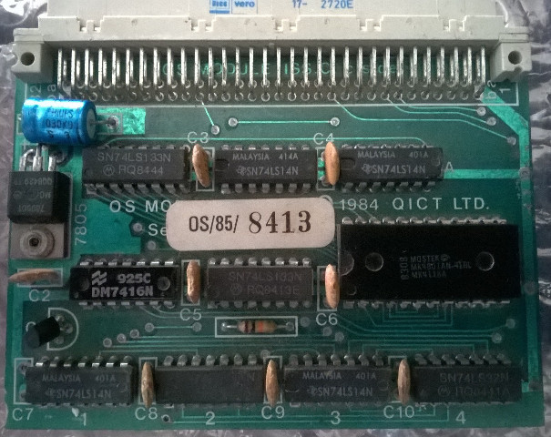

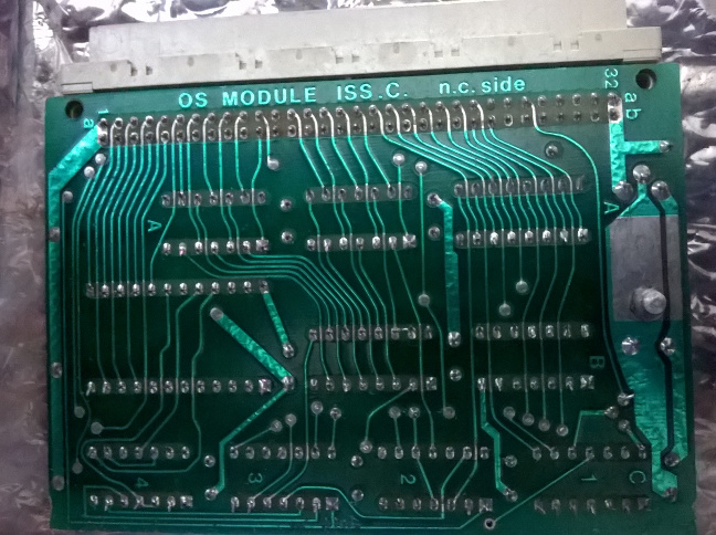

Here are some quick photos od the OS Card Module I bought many years ago with some Quest M68K CP/M 5.25" discs.
Not if the card work with the Quest M68K CP/M.
I have a 40/80 Track 5.25" drive from a newly aquired BBC Micro, so that sure read the discs.
QICT LTD OS Card Back
QICT LTD OS Card Front

Looks a bit different...?!

Yes, the picture on the QL Wiki is taken from their advertising and is marked MPC Module Iss A - so not sure if this might just be an early version or something different (certainly their pull out brochure made only a reference to the OS Card)..
Other than the board being reversed there does not appear to be that much difference - but you cannot tell from such a poor image...

The large chip: Mostek MK4801, looks to be a 1K 8 Bit Static ram chip. This must store the CP/M setting.
One thought was how the OS Card connected to the QL and disk interface, as most of the Quest interfaces I have seen are not through ported. Maybe a Expansion port system was sold with the M68K CP/M system.
I will see if I can get the system up and running, with old BBC 5.25" drive, I have a Qplane and a Sandy Disk interface. Though the voltage regulator input/Outputs will have to be shorted out to get the interfaces working on the Qplane system.
Derek,
I would actually have expected to see more RAM - CP/M 68 k requires RAM at the lower addresses by design (applications are normally loaded at $400 if they haven't messed it up completely), so I'd have expected to see at least 64k RAM there to replace the QL's ROM for the vector tables and the lower area of the TPA. Or maybe it's really something entirely different.
