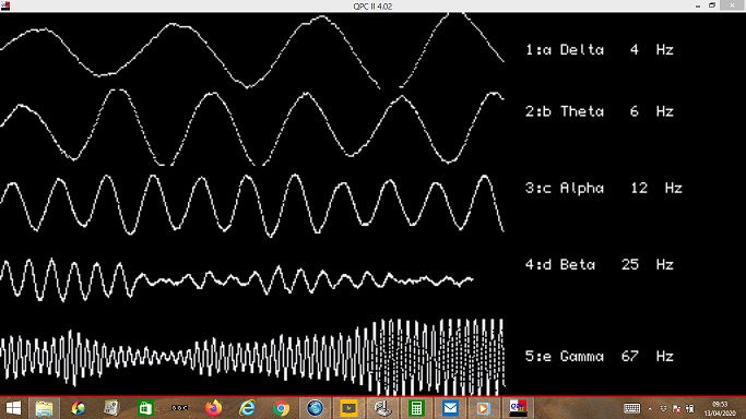

Here is a screen shot of five jobs running together. As you see, I only need to transmi keys 1 2 3 4 5 or a b c d e . This needed ten-char POKE$ and PEEK$, using a pseudo-binary string '12345abcde', where INKEY$="" are represented by zeros. So job1, say, only tests for '1' or 'a' ....
With PIPES, only the last job gets inkey$, and has to pass it back down the inversed call sequence to each job.
The KEYHOLE method can turn any job off, with keys a to e, without the whole lot coming crashing down !
Keys 1 to 5 just tempoarily 'puts the job to sleep', by not outputting the screen waves.
And you can tailor your peeking and poking to your exact needs... as long as you respect the buffer length.
Steve.

The multitasking program, (in the last posting), runs OK under qpc2, but fails under Qemulator.
First, Qemulator refuses to EX several SMSQ/E programs_bas. It will EXEC Qlib compiled programs though.
Also, there seems to be a Qemu problem with ALCHP() : A Boot program reserves some memory, then Lruns a second program which also reserves memory, but then Peek$ & Poke$ corrupt the name table, if the first base adress is used ... (OK under QPC2).
Does Qemu do a CLCHP when it does a NEW for LRUN ?
Steve.

Re: How to start a SBASIC from other languages (e. g. C, ASM)
Memory reserved by ALCHP is indirectly cleared by NEW, CLEAR, LOAD and LRUN - On all platforms - with QPC2, you've probably just been lucky.stevepoole wrote: Does Qemu do a CLCHP when it does a NEW for LRUN ?
If you want allocated memory to survive killing the S*BASIC program, you need to revert to another toolkit, like BTools ALCHP, for example.
EXing SBASICs should work on any system running SMSQ/E. Are you sure you loaded SMSQ/E and not Qdos? Theres also something called MBASIC on Minerva which works in a similar way.stevepoole wrote:Hi everybody,
You were just "lucky" that SMSQ/E hadnt used your memory for anything else. Thats how you could still apparently access it after a NEW, LRUN, etc. If you want to reserve memory that survives a NEW etc, you could try RESPR instead of ALCHP in your boot program.Also, there seems to be a Qemu problem with ALCHP() : A Boot program reserves some memory, then Lruns a second program which also reserves memory, but then Peek$ & Poke$ corrupt the name table, if the first base adress is used ... (OK under QPC2).

Hi Tofro & per,
Thanks for your comments. Yes, I was very lucky using QPC2 : Otherwise I doubt if I would have suceeded at all ....
I took your advice abot RESR() etc, and now have even a safe QDOS working program version. ! Tested and beta-tested.
Just a few quirks to eliminate, as we are working with four platforms, and with dos5_, win, ram & flp versions (in _bas & _task).
So it is oh so easy to get files mixed up !
The KEYHOLE method does indeed work well using all versions.
Steve.
