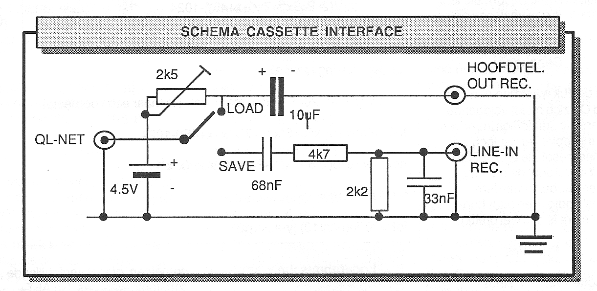

I recently read on Your github basicode repository, that you had designed a tape interface for the QL using qlnet. Can You provide documentation, schematics to built this interface?

I do have the schematics but have to scan it from the magazine where it was published, I'll do it asap.msch wrote:Hello Jan,

This is the interface I was referring to.
The LOAD section should be connected to the recorder's headphones or line out jack.
The purpose of the battery and 2k5 potentiometer is to provide a pull-up to the QL's net input so it's just around the point where bit 0 of I/O port $18020 flips from 0 to 1 (check with REPeat l:PRINT PEEK(98336)).
Of course you may use any DC source available (if more than 5V, it may be wise to put a resistor in series to avoid over-voltage on the net input).
Jan

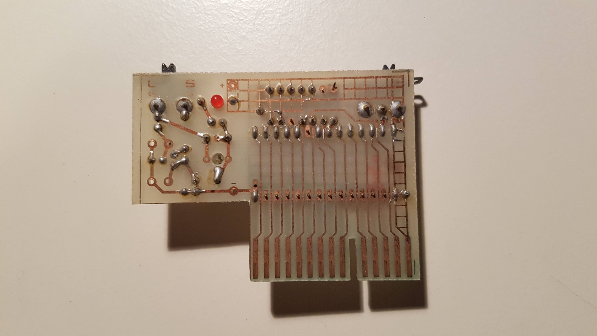

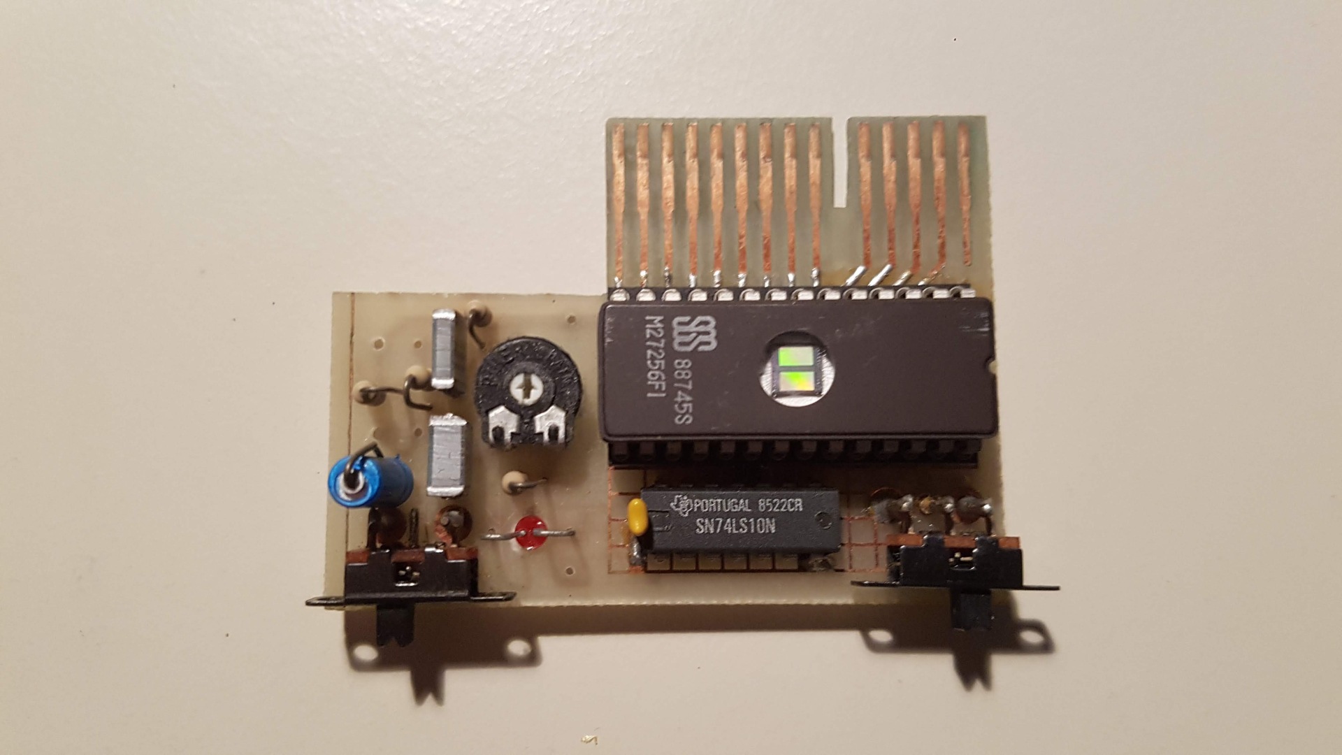

A member of the Sin_QL_air user club has even made a ROM cartridge with built-in cassette interface.
Note the extra LED and 32K EPROM so you can switch between two ROM extensions...
Jan
