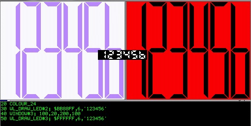

Or you could try a different approach altogether: Use BLOCK or WM_BLOCK to draw your seven-segment characters. It has been done before, by W Lenerz. In fact I devised an asynchronous timer toolkit incorporating Wolfgang's code. The timer is perhaps not much use to you as it is designed for use in S*Basic programs that need to sport a timer that just keeps going whatever else the program is busy doing. It can of course be read and controlled by your program. It uses the RTC rather than the 50Hz interrupt, ie the resolution is a second.
I dont know if its available online anymore, but if youre interested you can always get it from me. The toolkit comes with the source code in assembler.
