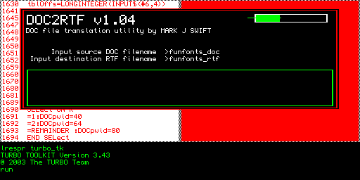

I had to change the following lines to make it run under the current Turbo Toolkit version v3.43, as STRINGL keyword is undefined, while LOGINTEGER seems a suitable replacement for it, correct?
tcat@lynx:~/ql/sw/doc2rtf$ diff DOC2RTF.bas doc2rtf_bas
89c89
< 1630  tblOffs=STRINGL(INPUT$(#6,4))
> 1630  tblOffs=LONGINTEGER(INPUT$(#6,4))
146c146
< 1817  txtOffs=STRINGL(INPUT$(#6,4))
> 1817  txtOffs=LONGINTEGER(INPUT$(#6,4))
155c155
< 1826  txtOffs=STRINGL(INPUT$(#6,4))
> 1826  txtOffs=LONGINTEGER(INPUT$(#6,4))
196c196
< 1869  txtOffs=STRINGL(INPUT$(#6,4))
> 1869  txtOffs=LONGINTEGER(INPUT$(#6,4))

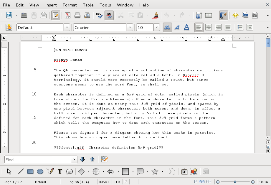

I ran the convertor on FUNFONTS_DOC article by Dilwyn, good news, I am getting an RTF output, but it has got some paragraph numbers at left hand and down the side. Pictures are referred with externally e.g.
$$$fonts1.gif Character definition 5x9 grid$$$
Cannot display these in Abiword nor LibreOffice Writer.
DOC2RTF_BAS in action
I may try recompiling it with current TURBO compiler version.
FUNFONTS_RTF output file

Thanks for the RTF reference link, I found what is confusing LibreOffice Writer, these TWO directives, they appear in the output only once as part of the header,
\linemod0 \linex0
the header code follows
{\rtf0 \ansi
{\fonttbl
{\f22 \fmodern Courier;}
{\stylesheet
{\s243 \qc \f22 \fs20 \sbasedon0 \snext243 footer;}
{\s244 \qc \f22 \fs20 \sbasedon0 \snext244 header;}
{\f22 \fs20 \sbasedon222 \snext0 Normal;}
\paperw11880 \paperh16800 \deftab606
\margl1080 \margr1102 \margt-1200 \margb-1200
\widowctrl \ftnbj \pgnstart1 \fracwidth
\sectd \linemod0 \linex0 \headery1200 \footery1200 \cols1 \endnhere
\plain \f22 \fs20
They are meant for line numering, while zero values may switch the numbering off, the Writer numbers every 5th line, and restarts sequence 5,10,15,20... on every page.
If directives \linemod0 \linex0 removed completely, numbering then disappears in the Writer, while it does not confuse all other editors I have tested, except MS*Word that I do not have and cannot test.
So I believe, nothing wrong with convertor, and I will be sharing the updated and compiled code shorlty.
