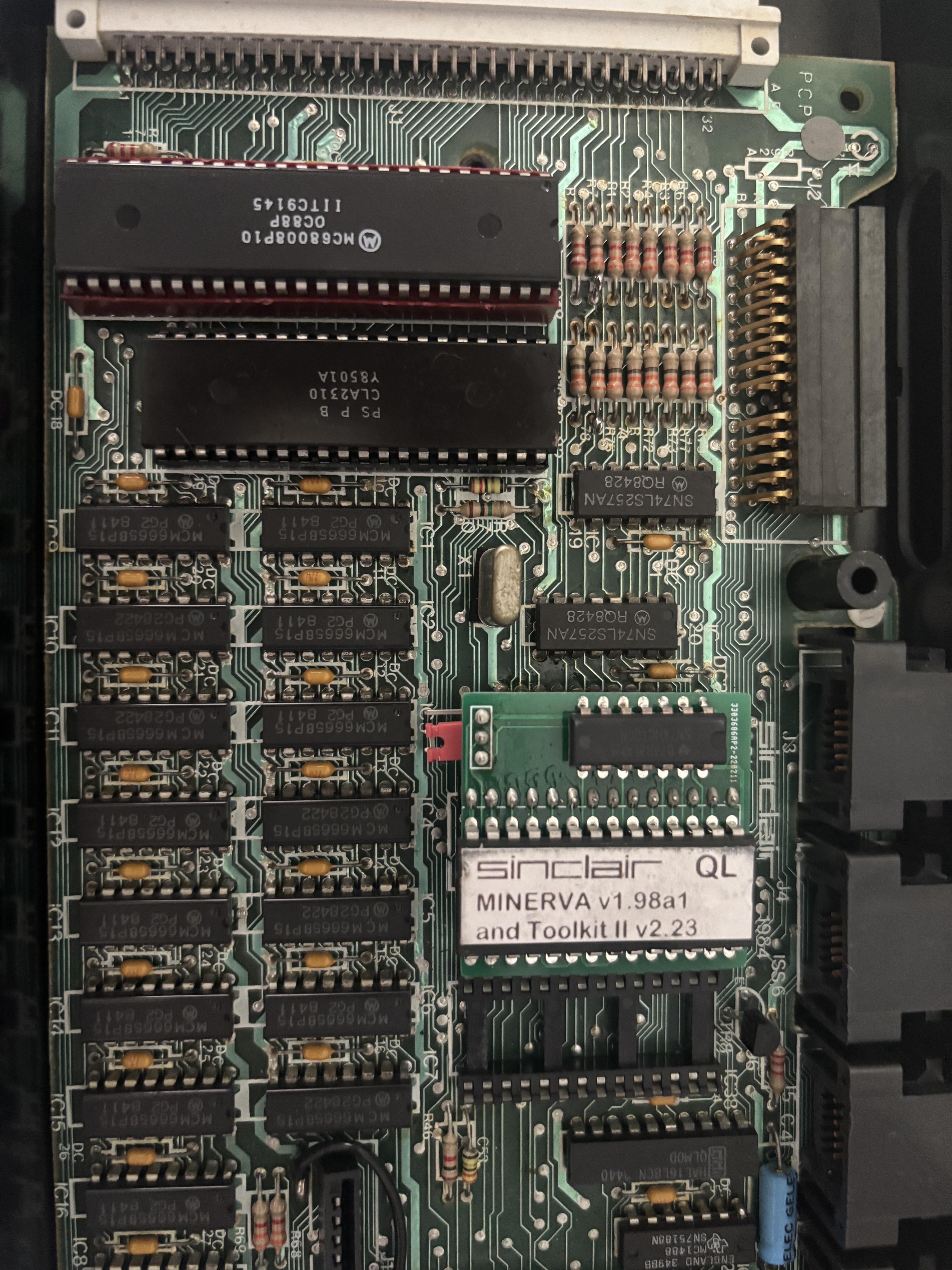

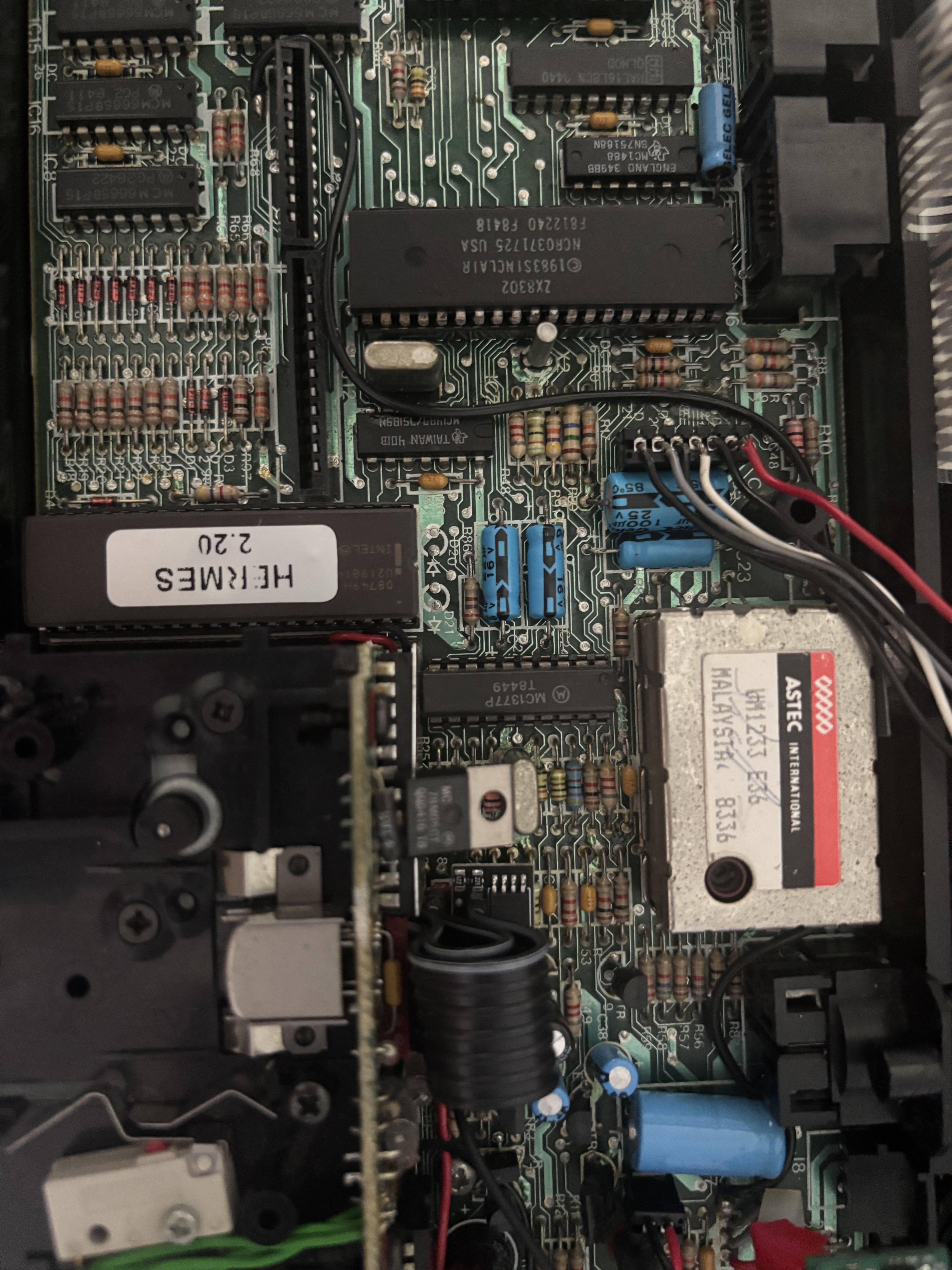

Here are some pictures of the top side of the board. Pictures of the bottom of the board, will take a bit more time as I'll have to take the whole thing apart. Let me know if you need to see the bottom side as well.

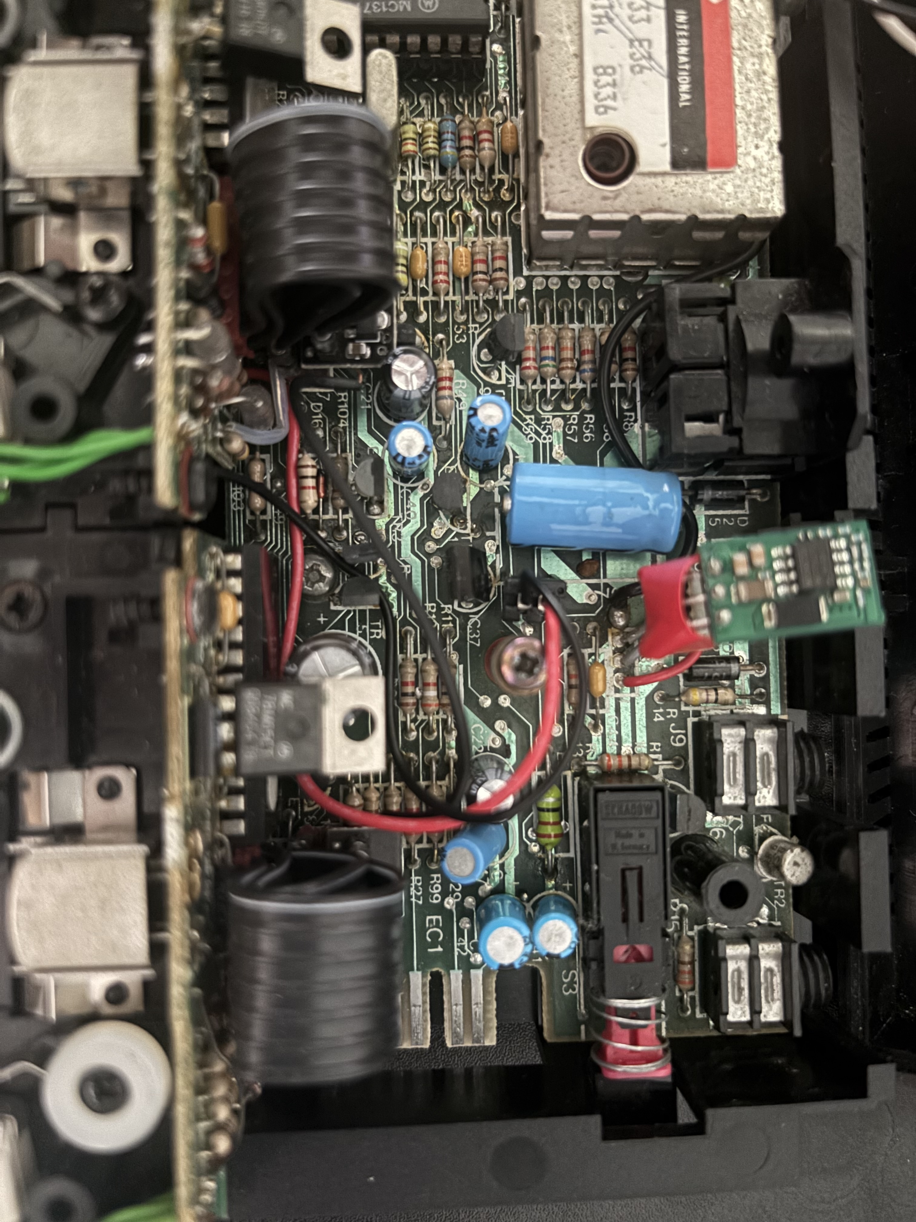

I can post close ups of some areas if required. I realize I still need to find a better way of attaching the new voltage regulator to the board.

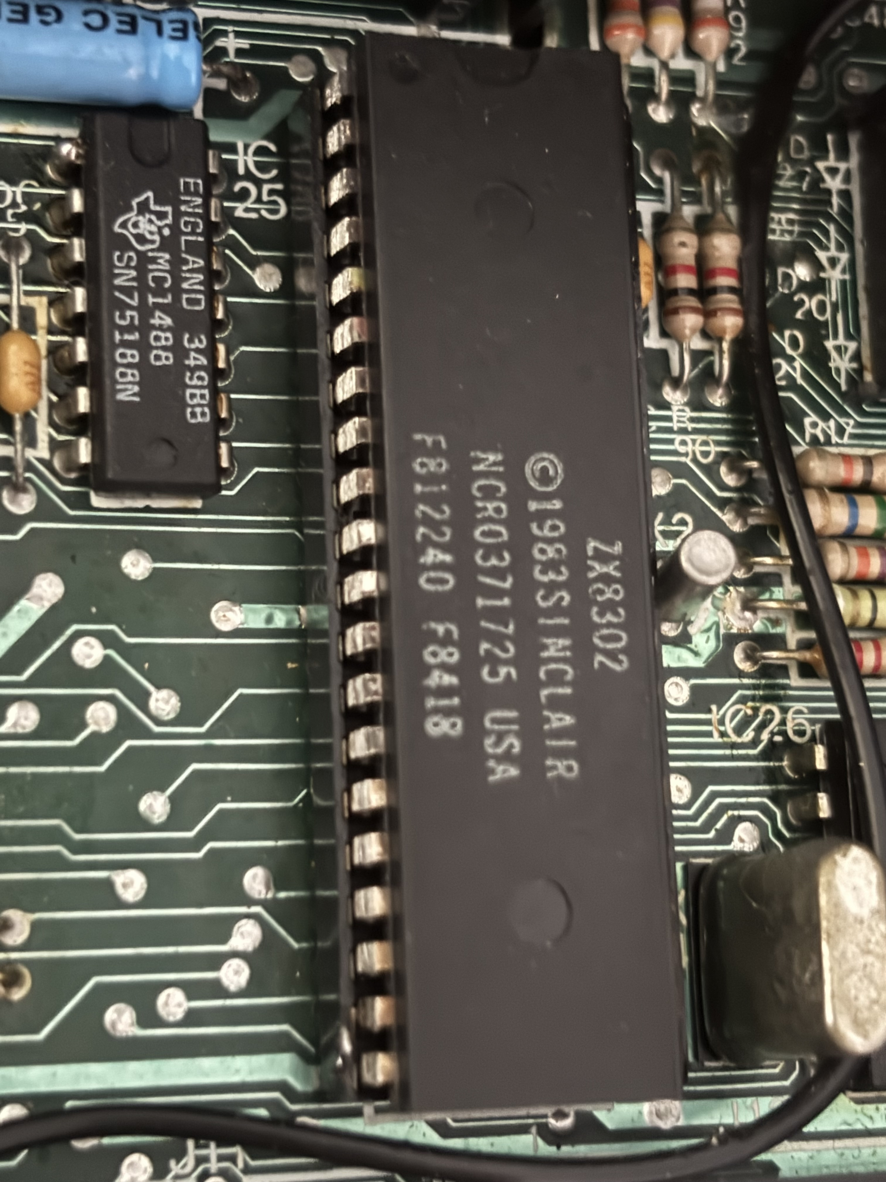

Looking back at my own pictures it doesn't look like I did a great job at cleaning the legs of the ZX802. Here's a picture of the other side of that chip.
This is the socket which had the most degraded solder and which I reflowed first.

Plastic CPU version I see.
That doesn't get too hot. So I would not consider the CPU responsible by now.
I don't see the 2 resistor mod that should lay on the ZX8302, perhaps you removed for cleaning purpose. They were there?
Capacitors doesn't look so bad.
Do you have oscilloscope? It would be interesting to check the clocks signals in case the searching for a hot IC fails.
The DCDC that you use for +5v is not good enough. I have used it for testing purpose and it may works barely.
That is a Chinese one. Please to use a linear one or something better (maybe TracoPower).

IIRC the replacement voltage regulator is an MuRata OKI Switch Mode 5v rated up to 1.5amps. I bought it originally for a 128k Toastrack but never got around to fitting it to the Spectrum in the end. The freeze was happening before I replaced the voltage regulator but if this regulator isn't recommended, I'll swap it out. Thanks for the heads up.
