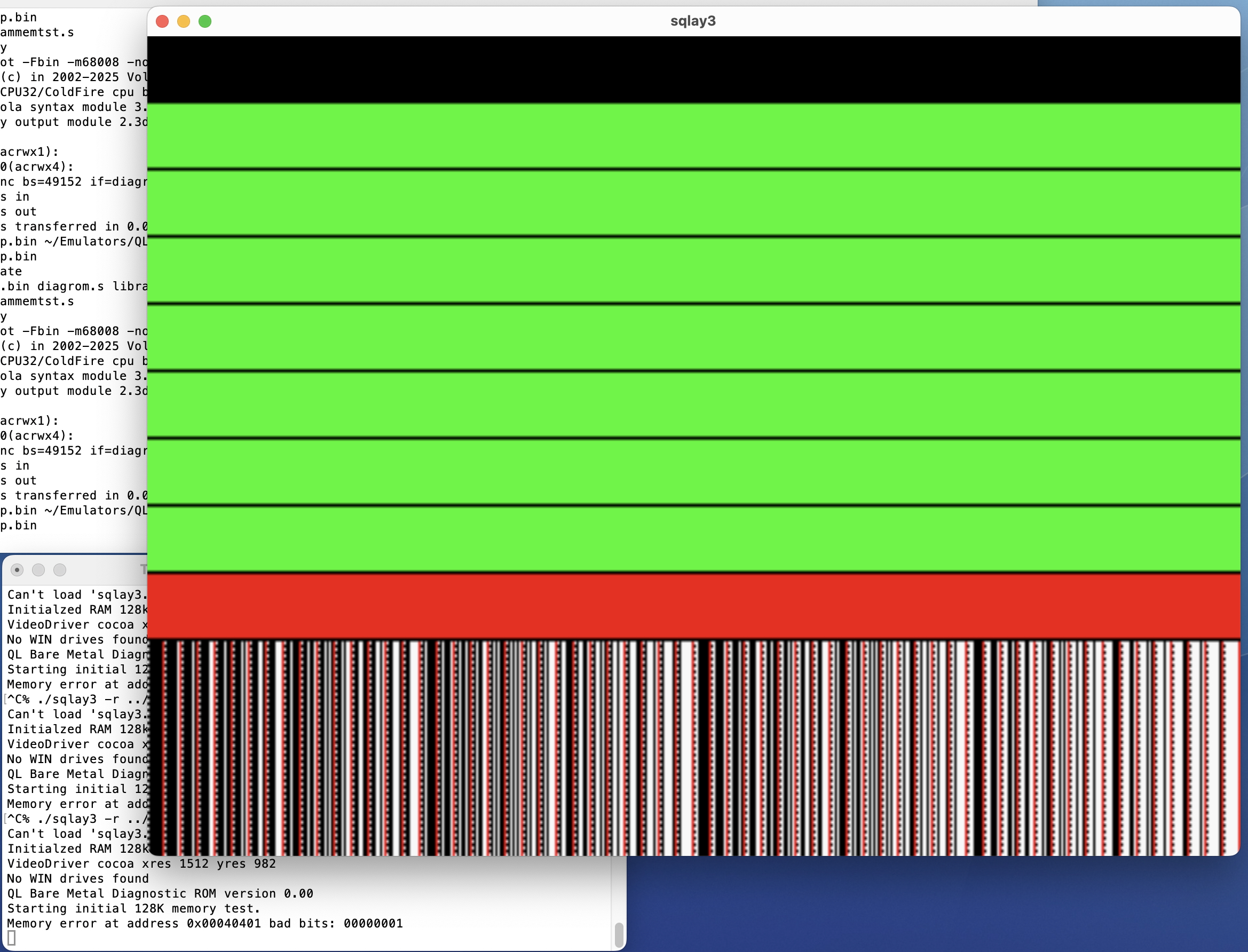

Re: Wondering if a "dead test" ROM is feasible on the QL.
I've completely re-written the base 128K RAM error reporting.
On the serial port it reports what address the error occurred at and the bad bits.
On the screen it draws nine bands, the first is the memory bank, white for lower and black for higher. This is followed by bands for each bit, 7 -> 0, green for correct and red for bad.
e.g.
e.g.

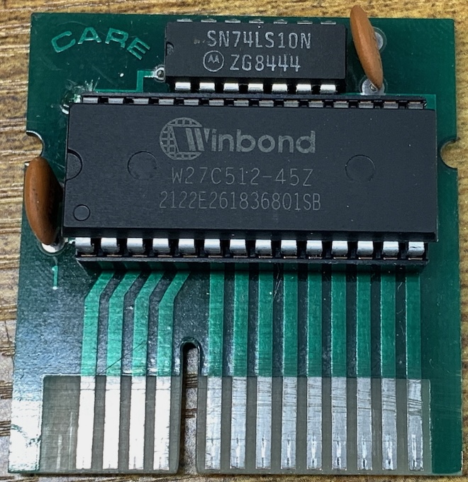

I think the easiest option is to use the pcb from here https://github.com/alvaroalea/QL_Rom_Cartridge . the full rom cartridge version.
Thanks, I'd got the wrong end of the stick about what rom cartridge was being usedjobdone wrote: Wed Aug 20, 2025 6:06 am I think the easiest option is to use the pcb from here https://github.com/alvaroalea/QL_Rom_Cartridge . the full rom cartridge version.

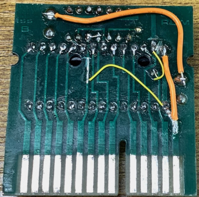

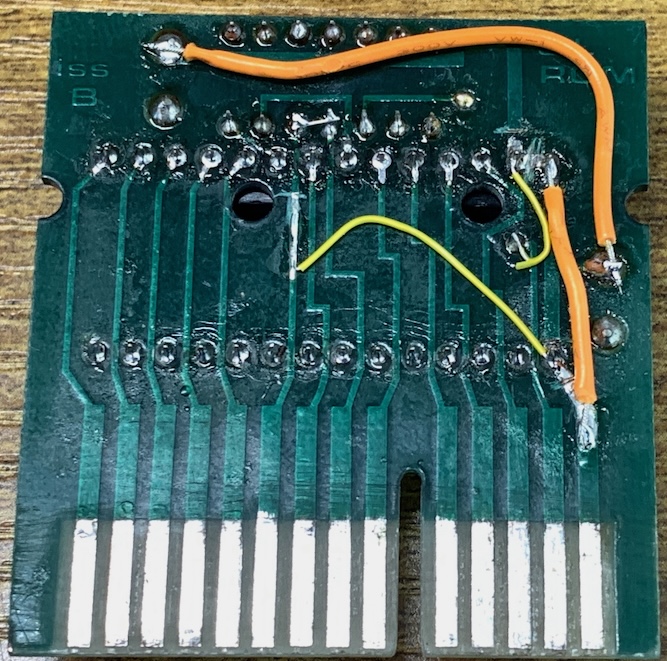

- Posts: 596
- Location: Oxford, UK.
Indeed, the new cartridge PCB is the best way.
I modified a cartridge I already had (which itself had been modified by someone else previously)...
