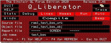

Can you compile just by using the command LIBERATE to bring up the "front end" window of the compiler, and compiling from there? You would need to create the work file (filename ending in _wrk) first if you don't have the QSAVE commands on your system. LIBERATE 'filename' (i.e. the version without the comma at the end) would generate the work file.
Steps:
1. ensure the compiler extensions have been LRESPRed (since you can get pass 1 working that seems to be in order), and that an appropriate QLIB_USE command is in force.
2. save the basic program somewhere convenient, e.g. SAVE ram1_test_bas
3. create the work file with the command LIBERATE ram1_test_bas which should create a file called ram1_test_bas_wrk (not sure if v3.36 would create ram1_test_wrk or ram1_test_bas_wrk like v3.46)
4. if LIBERATE "ram1_test_bas_wrk", doesn't compile, try just the command LIBERATE to bring up the front end screen and fill in the boxes (this is version 3.46 on my system, not too different to the v3.36 you said you had apart from slight differences in handling the filename extensions, which you'll soon notice, on some versions it finds the extensions automatically, others you have to type them in).
QLib front end
QLib front end
The options across the top are the same ones as used in the 10-digit string as last parameter of QLIB_USE (see section 14 of manual).

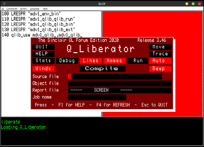

I have download QL2K and copied QLIB 2.46 to an MDV image, load the MDV image to MDV1 and started up QL2K
I use a smaller boot programme, that only loads the bare minimum: ENV_BIN, QLIB_RUN, QLIB_BIN, QLIB_EXT and set QLIB_USE "mdv1_qlib_","mdv1_qlib_"
Once the basics are understood, the other extension like Overlay file can be used, See the user manual for more information.
Qliberator v2.46 need the environmental variable extension - ENV_BIN
See screen shot of loading the Qliberator front end with the LIBERATE command:
have saved the Qliberator v2.46 files to a MDV image if this helps
I have compressed the MDV file due to rubbish Forum setup not allowing MDV files. Just uncompress with any unzip programme and insert into the QL2K MDV directory.
**** I uploaded the wrong zipped up MDV image, this is the correct one
