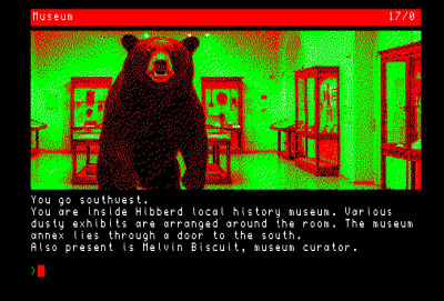

Back again, just to say the files have been updated. The links in the message above now give the latest versions. Sample screenshots below...
