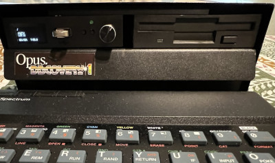

Have fitted a new GoTek (with the CONFIG.opd image set to auto mount at power on), a new black front bezel/button for floppy and re-soldered the broken joystick cable
Just got to learn more than the basics about using it now
The GoTek & floppy aren't as high as the original floppy drive and as the plate they mount on has no fixtures at the front (it just relies on the outer case holding down the drives/plate) I've put a temporary spacer in until I can find something better (play spot the QL space bar)

I'm a prat
I purchased 10 off DSDD 720K Floppies and I could only format a couple of them, and they were very temperamental
Then I realised I'd set the config to 80 tracks per side, but only 40 in total for the disk (though this actually was a bit of a red herring) so corrected that, still no joy
Then tried formatting the disks on the QL and they all formatted fine (one was slightly noisy but all formatted to 1440/1440)
I then realised that the spin speed was dodgy on the Opus, a couple of disks struggled to spin up at all at times and weird things were happening
Of course the real problem was the QL Spacebar "spacer"!
It was pressing down on the floppy drive causing issues, as soon as I moved it to only press down on the gotek I was able to format all 10 disks fine. What a prat
