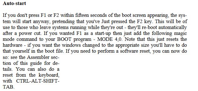

What I find interesting: The QEM Minerva must be patched, theoretically at least, because Minerva usually always started automatically in TV-mode, at least that's how it used to be. That used to really bother me.
Or it was changed at some point.

Unless you turn off SKIP_BOOT the emulator always presses the F1 key (if thats what you mean)

RalfR wrote: Thu Mar 06, 2025 4:39 pm What I find interesting: The QEM Minerva must be patched, theoretically at least, because Minerva usually always started automatically in TV-mode, at least that's how it used to be. That used to really bother me.
In my memory, the original Minerva never did anything, just sat there and waited for you to press F1-F4 - forever. Everything else is a patched version, IMHO.
Posts: 1222
RTFM ;)
Posts: 1680
The ROM isn't editied in that way
*       bit(s)  value   meaning
*       0       0       do the full memory test
*               1       skip the memory test for a quick reset
*       1       0       scan rom slots
*               1       skip the rom slots, unexpand the m/c
*       2       0       normal establishment of memory size
*               1       take the upper memory limit below as gospel!
*       3       0       monitor mode
*               1       tv mode
*       4       0       wait for f1-f4 selection
*               1       skip the f1-f4 selection
*       5-6     0..3    extend supervisor stack by 0K, 8K, 16K or 24K
*       7       0       set single screen
*               1       set dual screens
*       8-13    0..63   extra blocks of 64k between last screen and system vars
*       14-31           upper limit on memory (0 = no limit)
* (Note that the top bits of d1 are unlikely to ever make sense as memory!)
uqlx code sets D1 on start 1 | RAMTOP so it does quick reset and monitor mode :-D
