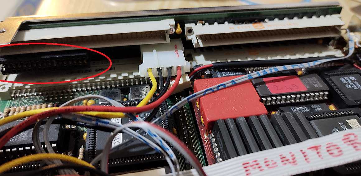

Aurora and QIMSI.
Someone asked about this. I tried QIMSI on my Minis-QL Aurora this evening. It works.
As my Aurora card has no QL-Style ROM port connector on the main board (and anyway there might not be room for the QIMSI because of the number of cables in the way even if it had a QL-style ROM port connector), it is replicated on the M-Plane backplane you can see in the first picture. Normally this is occupied by my old RomDisq simply because I had no other use for it these days. I removed the Qubide from the backplane (to avoid WIN name clash). Leaves just the Aurora, SuperHermes Lite, M-Plane, Super Gold Card and floppy disk drive.
The second picture shows the QIMSI plugged in where the RomDisq used to be. You can see the RomDisq resting loose on a cable in the picture, since I was too lazy to free it from its LED cable. Obviously, for the Aurora's PS2 keyboard to work via the SuperHermes, you have to copy the ipcexts file to somewhere where it'll boot from. Seemed to work fine from QIMSI.
So it seems to work fine. The QIMSI is upside down in this particular system so you can't see the LED, and the micro SD card slot is beneath the board making it hard to see to insert a card if you want to change it.
Apart from that inconvenience, all seems to work OK.

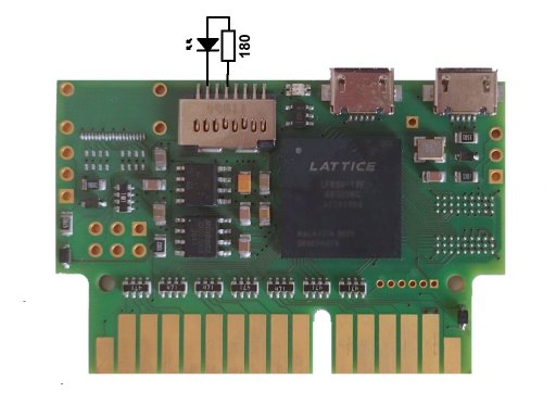

Many thanks. It was not me who asked. But this is a scenario we could not test yet, and I'm glad to hear it works!dilwyn wrote: Sat Oct 21, 2023 7:45 pm Someone asked about this. I tried QIMSI on my Minis-QL Aurora this evening. It works.
Unfortunately this is a use case I did not have in mind at design time. It would not have been difficult to provide pads for an external LED.dilwyn wrote: Sat Oct 21, 2023 7:45 pm The QIMSI is upside down in this particular system so you can't see the LED, and the micro SD card slot is beneath the board making it hard to see to insert a card if you want to change it.
Right now, without design changes, an external LED would require soldering at the pads of the microSD socket according to the following picture: With thin wires, not impossible for an experienced tinkerer. But only makes sense if the card is rarely changed. (Inisde a MinisQL case, replacing RomDisq, I would expect that.) Another option might be a microSD extension cable/adaptor.

Exactly Peter. It is not an issue for me because my QIMSI will only be used with a QL. But as someone asked about Aurora, and I have one, I thought I would try it out to see if it can work.
I was quite used to the old RomDisq being hidden away inside the Minis-QL, I'd run a short cable to an LED on the front panel since the RomDisq had a couple of pins for this purpose. Until I dismantled the case to try the QIMSI I'd actually forgotten that the RomDisq extension LED was there.
As a BTW, the Qubide in that Minis-QL system used to have a small mechanical hard disc. That hard disc is now in the great hard disc graveyard in the sky, so using a small IDE CF card board, I replaced the hard disc with CF cards, which are just fine for me. I added the RomDisq as a sort of internal backup for the important system files in case the use of CF cards didn't quite work out as I expected it to. As it turns out, 8MB RomDisq was more than enough enough for that, but has never been needed.
