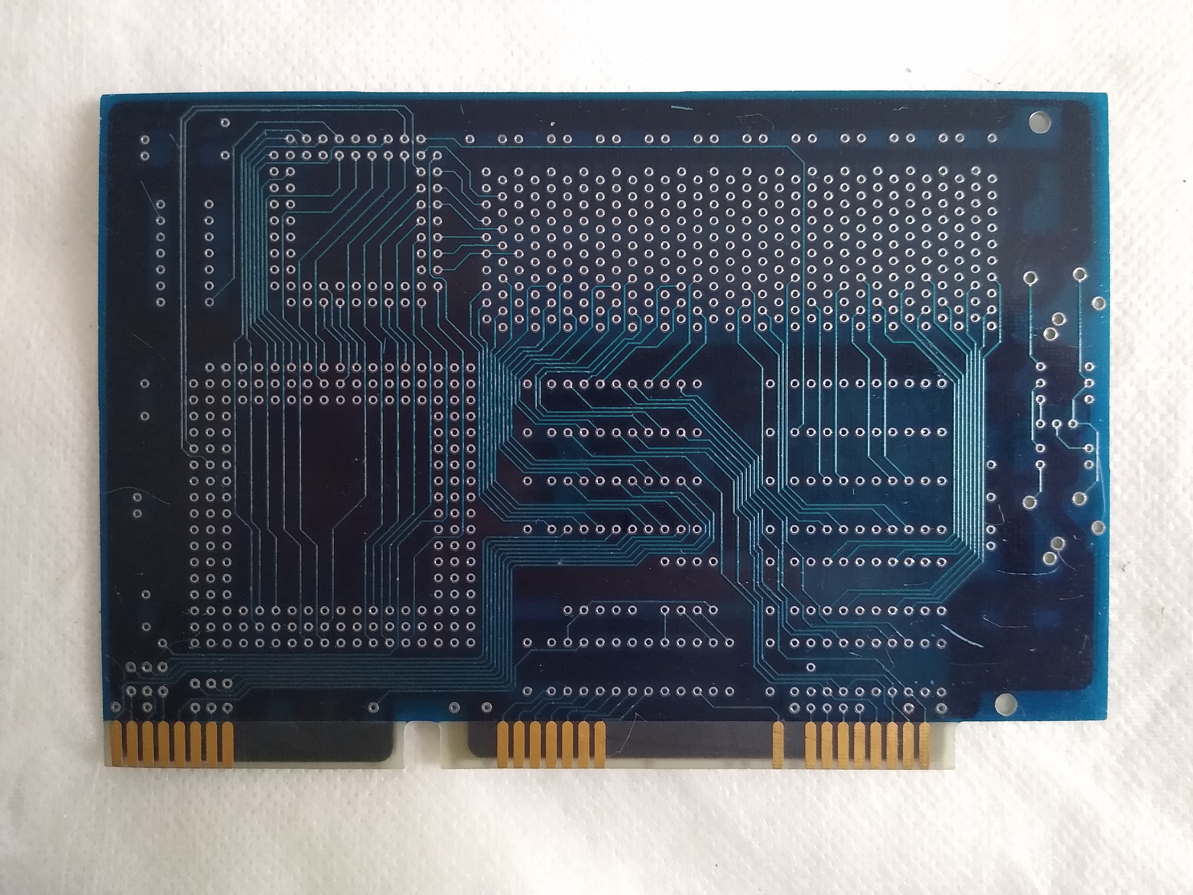

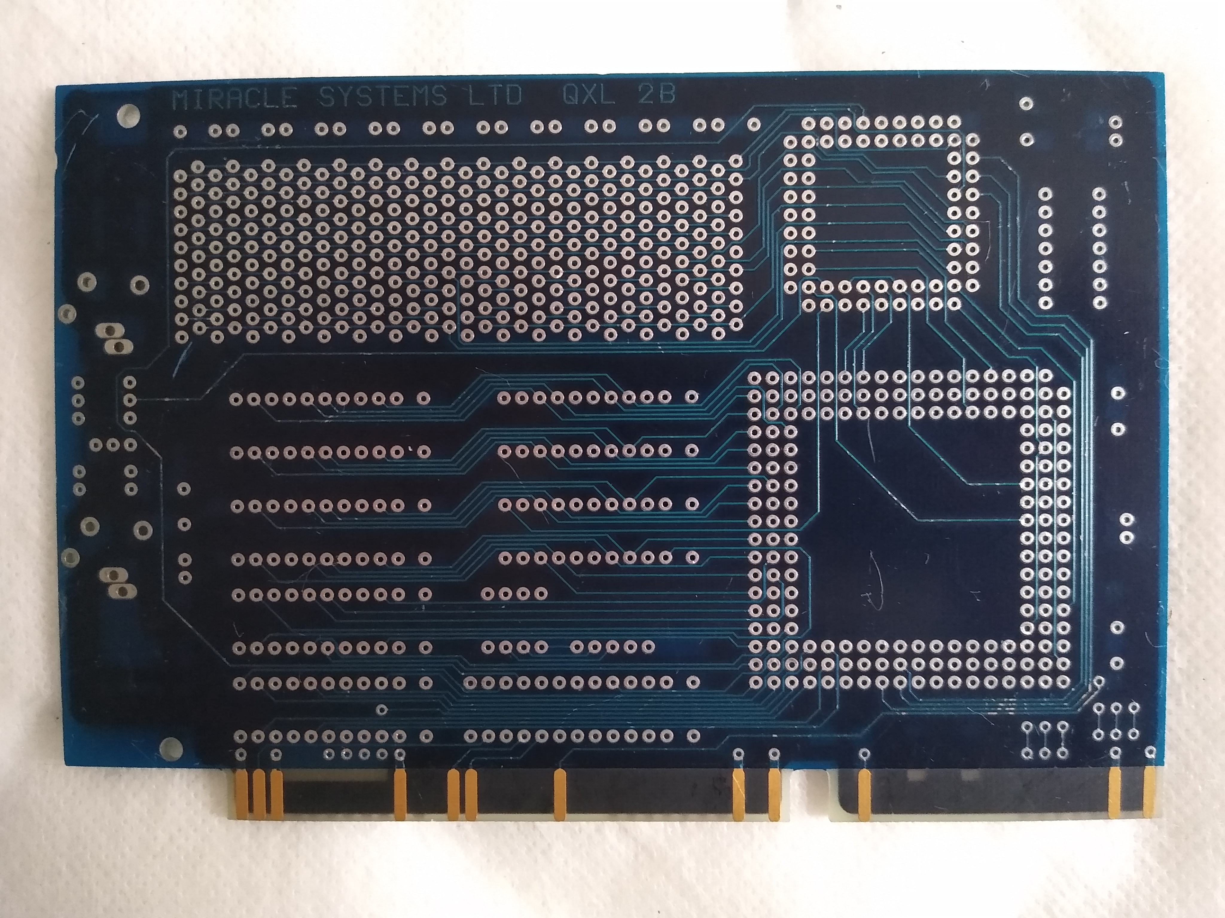

You might be interested in this:
QXL PCB Top
QXL PCB Top
QXL PCB Bot
QXL PCB Bot
Last edited by Derek_Stewart on Thu Mar 07, 2024 12:17 am, edited 1 time in total.
