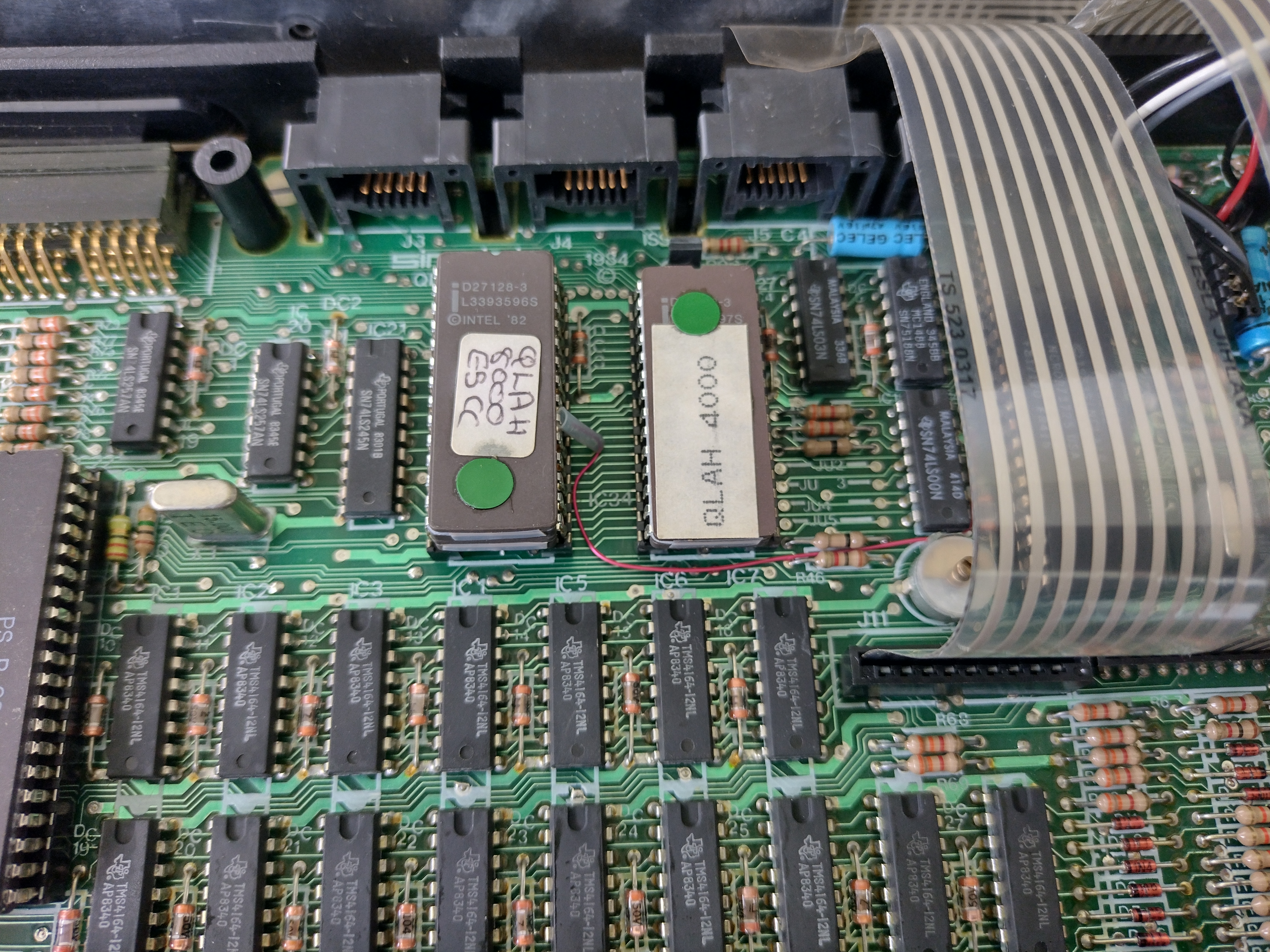

I have got what must be a relatively early Sinclair QL with an AH ROM. See attached photo. Its got the piggybacked ROM on left slot, then a wire attached to one of the pins.

That's my ebay listing you're referring to, and I put that because I haven't seen one like that and wasn't sure what was going on with them.
To remove your current setup I think you'd have to change some of those JU jumpers to the right of the right-hand chip and of course remove the 3x EPROMS and the wire. That motherboard has a 74LS00 chip (later ones didn't), which is required when using EPROMS but is not used when using the conventional Sinclair branded ROMs.

I had the same QL AH version as you. I had to upgrade it to Minerva when I installed QL SD. If I remember correctly Marcel documented all changes in the QL-SD Manual.palmheads wrote:Hi

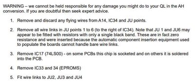

There's a section in QL-SD manual which describes upgrading a system with AH EPROMs, don't know if this is of help.
https://www.sinclairql.net/srv/qlsm4.html#s4 (Section 4 Firmware Upgrade)
Also, the QL service manual section 4 has information about upgrading a machine with EPROMs - although I can't remember if that referred to early FB QLs or if still relevant to AH machines.https://www.sinclairql.net/srv/qlsm4.html#s4 (Section 4 Firmware Upgrade)
