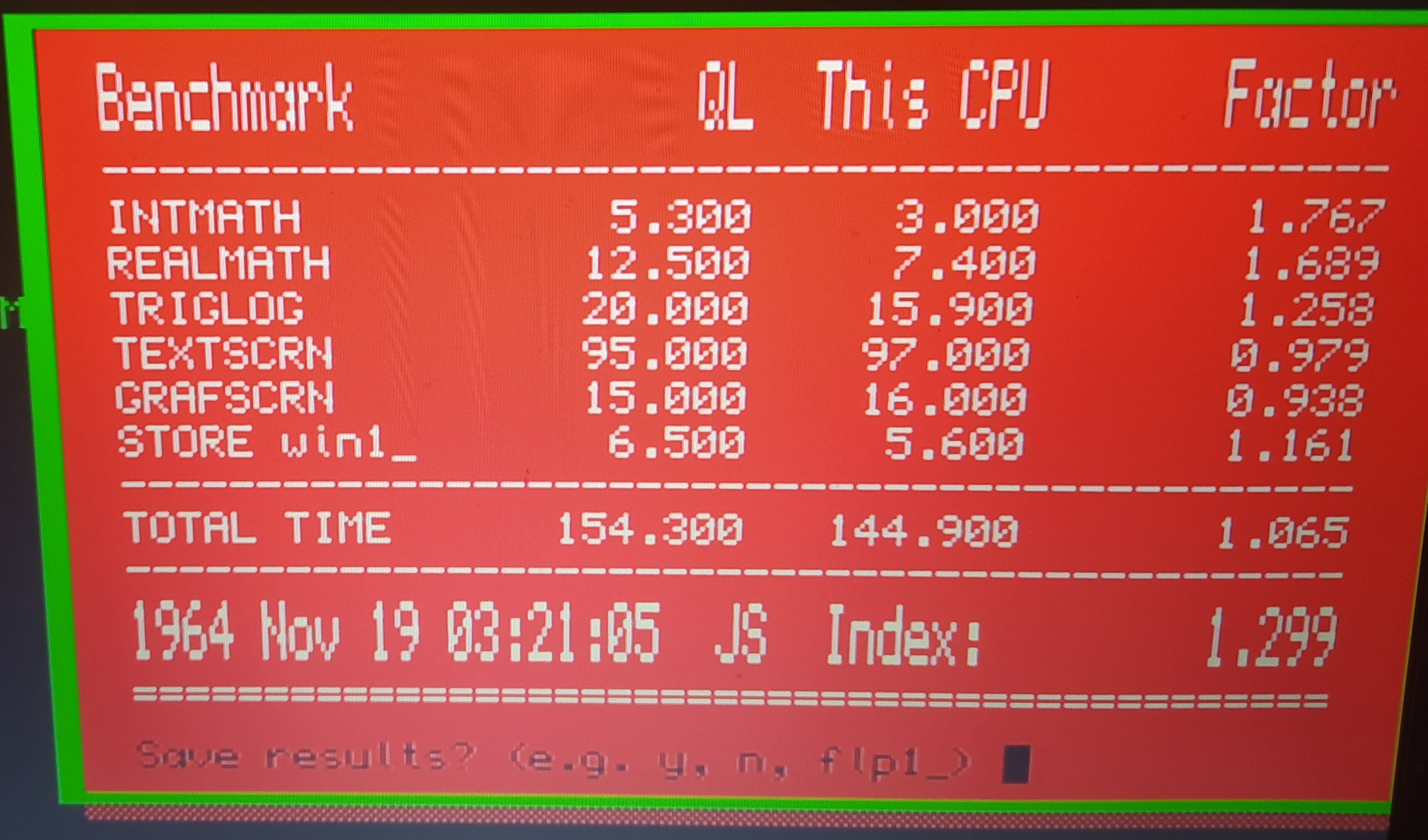

I time the two by hand with my phone's stopwatch so it is not an accurate measurement, but I always got better times with the one of the two ULAs.mk79 wrote: Cannot make heads nor tails of the speed difference you report. Are they as consistent as you say? As far as I know there are only two revisions, the old CLA2310 and the later CLA2345 which added NTFS support.
I did the tests between them with the memory upgrade on maybe this has to do with the difference.
I also did once a test with a program :
I noticed twice a small black square (smaller than a char) scrolling up with the numbers while I was testing the fast ULA, could it be that it is faster because of a problem with it?
I don't know but it doesn't matter anyway,
What is nice is that the cpld is faster than both.
