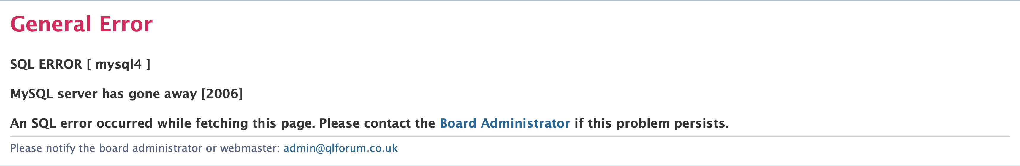

there looks to be a problem somewhere. Nasta's post that I responded to appears to have vanished!
I had to delete one of my posts this morning as I had a duplicate, but it was definitely my own that I deleted. I've seen the SQL error occasionally too, and I suspect that this might be causing the duplicates. I see to remember the error being "SQL Server has gone away".

NormanDunbar wrote: I had to delete one of my posts this morning as I had a duplicate, but it was definitely my own that I deleted. I've seen the SQL error occasionally too, and I suspect that this might be causing the duplicates. I see to remember the error being "SQL Server has gone away".
I've experienced similar issues during my last few posts (mainly related to editing a post I've submitted a few minutes before) and seen the "SQL Error" page as well. Re-loading the post, however, showed my edit had gone through and even created a duplicate entry (which I deleted).

Now i just wanted to save this post. See what happened:
