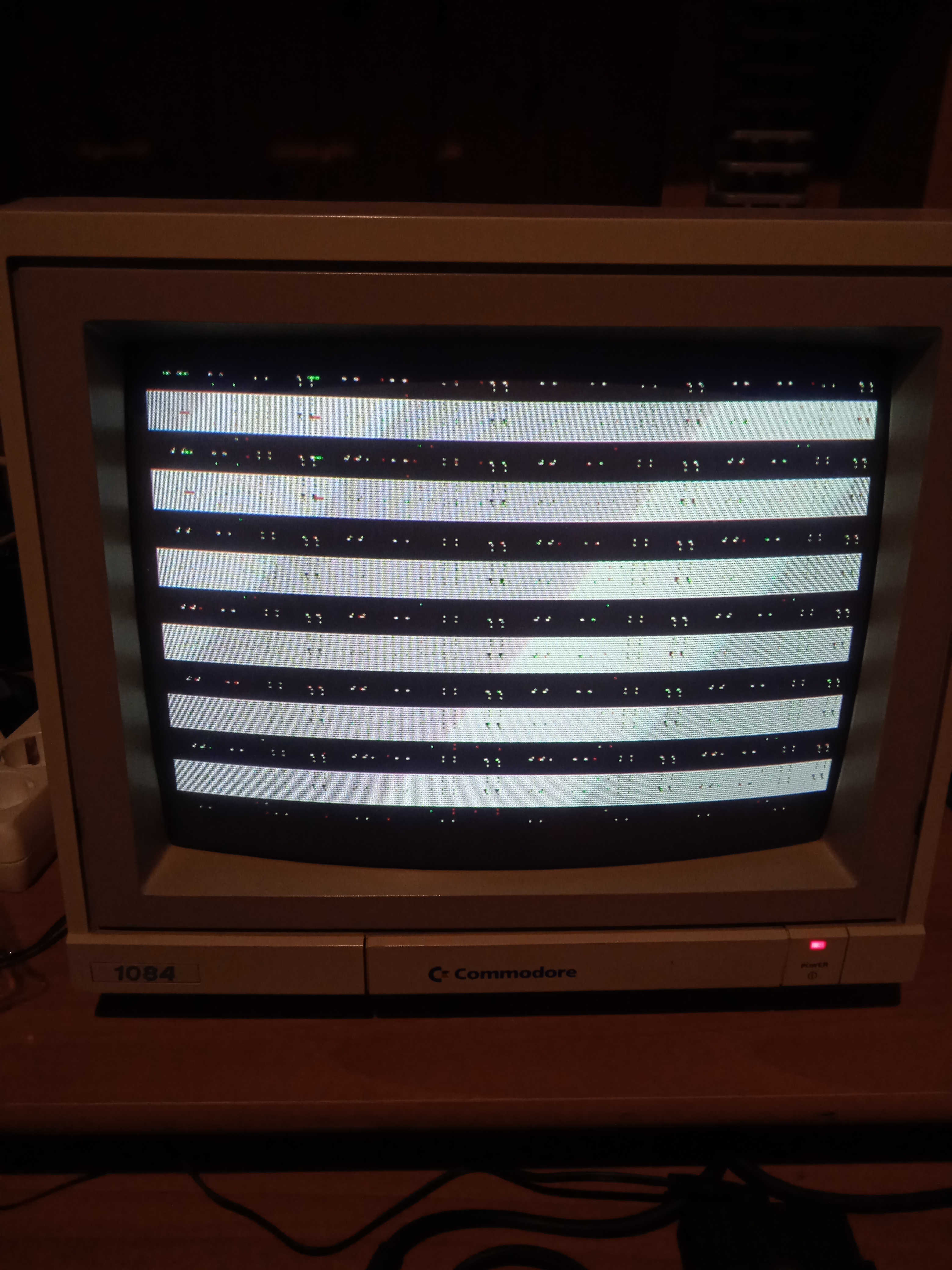

Th QL with gold card plus ICE while working well running a heavy program (molecular graphics) Suddenly freezes .
After reboot the screen is like the attachment photo. Is the zx8301 faulty?

Help is it zx8301 failure?

Did you try and boot without ICE and Gold Card to see if you get the same screen. If so, try to re-seat all of your chips that are socketed. If that all fails then it's likely a bad IC.
Re: Help is it zx8301 failure?
ZX8301 aparently is doing something (generating picture).
Very probably it is not faulty.

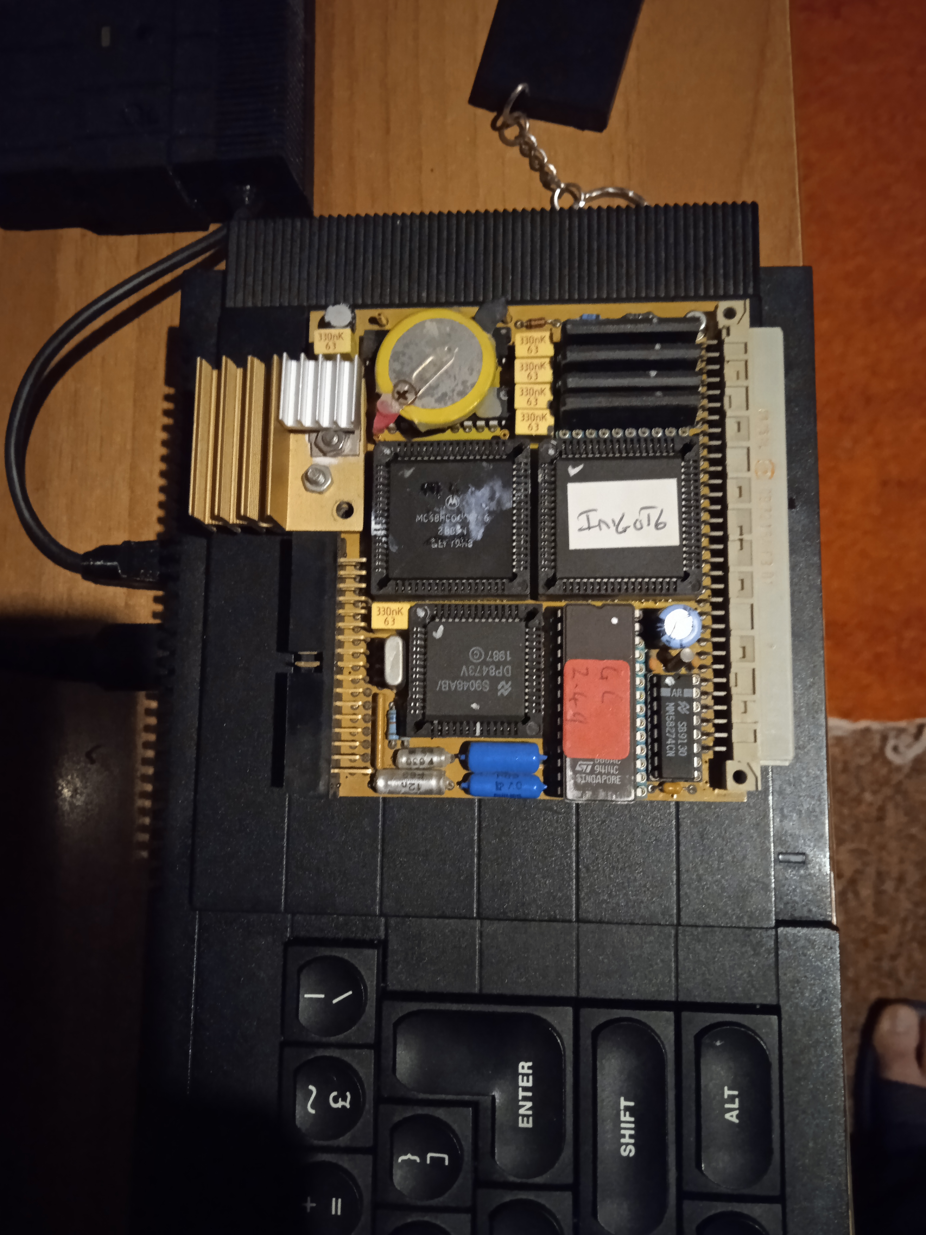

Dex you are right. The problem is with gold card. What can I do ?

Picture looks like what Ive seen with RAM fault outside 128K, so try re-seating that ram on GC.mhanias wrote:Dex you are right. The problem is with gold card. What can I do ?

Thank you very much Xor. I re-seat the AR chip and move a little the ram chips ()they need desoldering) and the Gold Card came back to life.
