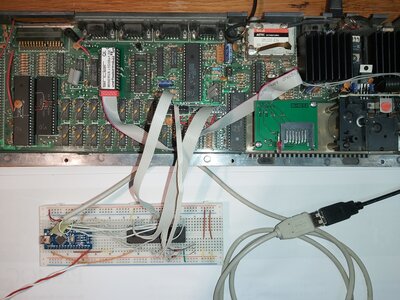

Hi all,
based on the project from Alex:
https://codeberg.org/xelalexv/spectratur
I build a keyboard interface for the QL. Basically it consists of an Arduino Nano and a switch matrix array MT8812. The matrix array is directly attached to the original keyboard sockets (J11 and J12) thus I expect only minor incompatibilities. It allows to attach a PS/2 or USB (emulating PS/2) Keyboard to the Arduino. Currently it is in a very early stage but I want to use the opportunity to ask for your opinion and features you may interested in.
So far what I obtained:
- Build the IF on my breadboard, all keys are working as expected. More testing is required
- Only add 2 additional keys so far, "Backspace" and "Delete"
- Only German keymap so far. No idea if modification for UK keymap is required. But it should be doable
What to do next:
- Build a proper PCB which fits inside the QL (obvious)
- Define keypad keys
- Any additional Key combinations required more than Delete and Backspace? What do you would need?
- Joystick support to map Joystick on (variable) keys. Is this a need from your point of view?
Any comment is highly appreciated.
Best regards,
Stephan

So 8x12 gives 96 keys. The QL has a 9x11 matrix for 99 keys. Which 3 keys are not supported. Also, in the picture I see 9 & 8 for ribbon cables going to the keyboard connector...so not all lines are used?
Nice seeing a German board. Very similar to the US ones except they don't have that little daughter board on top of memory near the CPU :)

I just counted the keys on my QL, if not miss-count there are 65 keys. Could anyone kindly double confirm :D
To be honest, there are no keys missing, even better, there are keys on the PC Keyboard which not even exist on the QL keyboard:
- Backspace
- Delete
- / (on the Key-Pad)
- x (on the Key-Pad)

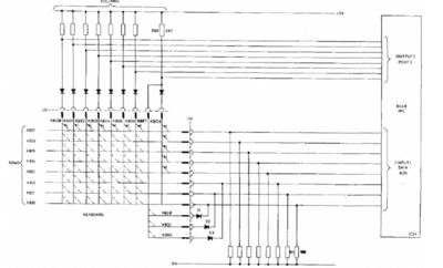

Also its a mystery that the QL has a 9x11 Matrix, the 8049 IPC only supports 8x8 Matrix. Kindly check the diagram below. So a MT8812 and 3 external diodes will do the job. 8 & 9 ribbon cable are correct, as I do not use pins 1,2 & 11 from J12.
