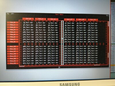

HAOUI wrote:Factually the overhead is exactly 236 bytes for wman
OK, that's actually less than I had remembered, certainly not a problem for SMSQ/E, sorry! My main issue here was telling that it's available and asking if somebody maybe has a usage for it in mind.

BSJR wrote: I wonder how QSpread fixed this problem when implementing the index items.
For a QPTR version of SuQcess I also tried to use the index item, only to find out later it didn't work at all.
In the end I stuck to the old way of using extra AWs, that need to be moved in sync with the main AW by the program.
Of course QSpread was all assembler while the current SuQcess is done in SBasic with EasyPTR with only a horizontal index.
Well, while doing I had a quick look over some QL spreadsheet and similar softwares using indexes and scrolled menus.
Indeed, QSpread handles indexes with its own (long) assembler code and the result is really very good.
The others used various tedious and painfully non standard/unified methods.
EasyPtr doesn't support indexes and I don't see how it can do it without a new Wman.
QPTR supports fully indexes but it is the Wman responsability to do Drawing, Update, Scrolling and Spliting operations.
Unfortunately, QPTR had some bugs in this area and packed wrongly datas but this had no importance as Wman doesn't use them at all.
What I did is exactly what was planed from the begining.
Using the fixed QPTR and the implemented Wman allows a full standard support of indexes as expected without any extra code.
I am really wondering how this cavity had never been treated over years and years, while several concerned softwares had been developed.
Damage, seemly it's too late but it is a pleasure to get it done anyway despite the wasted effort.
