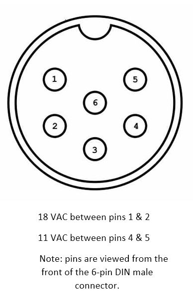

Thank you for advice. Maybe I can try one of these adaptors and replace the mini-DIN with a standard DIN connector.
I need the pin layout configuration of the 6-pin DIN connector (the one on the original PSU or on the MIcro Peripherals QLFDC device plug). Anyone?
Thanks.

Re: Anyone with a psu for Microperipherals Floppy Interface?
Still looking for the pinout of the disk drive DIN6 plug. Please help.
Great, thank you very much!

My other question is if the PSU is outputting 15Vac and 9vdc how are the 6 pins in the diagram
containing 18vac and 11vac?

Yes, it's still an ongoing issue. At least in my case, as I still didn't find a valid PSU replacement.
And yes, as you pointed out, @bagpuss22, the diagram shows different voltages form the ones that appear on the original PSU.
In your case. I think you need the middle drive or an proper voltage converter.
