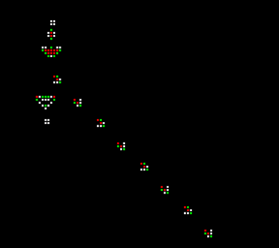

On the attached picture, I show a snapshot of a demo comprising little (diagonally) crawling organisms called "gliders" and one bigger organism which is a "bomber" shooting a new glider every 30 generations. As the world is warped, you see the line of gliders going out of it either through the vertical or horizontal borders but reentering it immediately at the opposite borders. And thus (you may notice that) the bomber will be finally hit from behind ! But it seems shielded from these attacks and simply destroys the incoming gliders without any harm. So after shooting 32 gliders, this warped world does no longer evolve on the whole (but if its dimensions were slightly different, the bomber might be hit somewhere else and desintegrate).
The first of the two afore mentionned tasks, I called it DAD and the second MOM, thus the forth definition of LIFE is simply :

More comments on the picture :
As (beside black) I could use three colours (in mode 4), I decided (for a better show - instead of black and white) that "just born" cells would be green, "surviving" cells would be white, and "just dying" cells would be red ; the green and red states of a cell lasting thus only one generation.

This program has two parts :
1/ from beginning to (& including) the definition of the function LAY, it implements exactly the same algorithm as shown in SuperBasic, a few posts above.
2/ after, it adds words for defining incrementally complex organisms : meaning that you may compose organisms with organisms with organisms etc.
For a start, let me just explain the first part : it's my solution for the famous issue of "hen vs egg". Look at the word LIFE, it repeats alternances of "egg" and "hen" - starting with "egg" (my opinion).
With ComputerOne FORTH, to stop the process at will, I used a convenient word ?TERMINAL reacting to a hit of the keyboard. This function is absent from SuperFORTH and I could only replace it with a call to KEYROW, that I coded (for speed) to work only with the space bar - and you have to hold it down till the function executes.
Beside the essential word LIFE, you have LAY a word to put an egg on a given square (a simple way to populate initially the world), and FLU a word to empty the whole world (the famous H4N1 avian flu virus).
To see this simulation running on a real QL or an emulator that uses the same display memory mapping, you have to install and start SuperFORTH, but if necessary - first thing :

Another "pretty" demo is started calling JOLI.
To time the execution, you may also use DEDE :
2 OPEN flp2_times 50 DEDE
that will write run times in a "new" text file for 50 surges of 30 generations (on a real QL, this takes time !) - each 30 generations a new "glider" is shot by the "bomber". Contrary to DEMO, DEDE cannot be stopped in the middle.
Have good entertainment !
