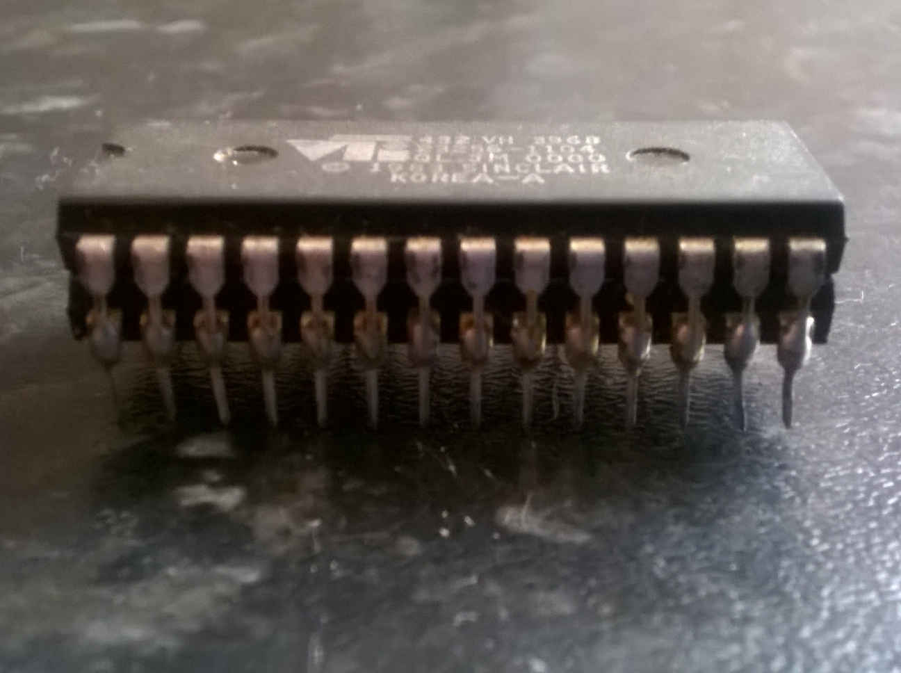

Ah I checked, I have the basic minerva mounted to the small board with one or two pins bent out into different sockets. I could just swap that out for the QL SD?

I think it's just the same as a normal QL Minerva. I'll take some photos tonight

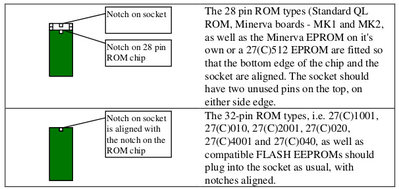

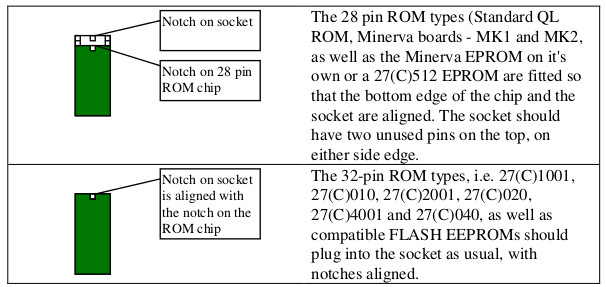

The Aurora QL ROM Socket takes a single QL ROM chip, that is the Minerva Mk1, MK2 boards or both QL roms soldered one chip on top of each other and plugged into the Aurora QL Rom Socket.
See attached photo...
The designs for a QL Eprom board will probably work in the Aurora as well.

If you look in the Aurora User Manual Apendix A.4 shows the QL Rom variations, either 28 pin or 32 pin Roms can be fitted:
