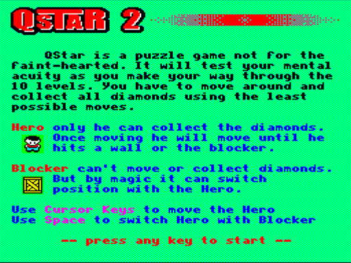

QStar 2 - another logic puzzle game!
It's a spin-off QStar 1, but with different game mechanics and only 10 levels, but harder.
This time the Blocker cannot move - but it can switch position with the Hero
And because is harder, it is possible to view a solution for the puzzle, not necessarily the one with the fewer moves, so can you find a better one? Please do not use this option unless you are really stuck!
