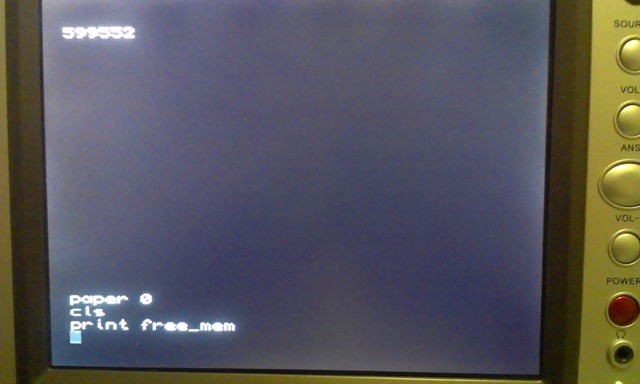

Using FREE_MEM to show amount of free RAM

Much better now:
Updated the GAL logic so /AS and /DS are both used and corrected the polarity of DSMCL output :o Both /DTACK and DSMCL are programmed to be Tri-State (floating) when not active. Created one pin to reflect the validity of the memory range and used that to enable the output of /DTACK and DSMCL signals from the GAL
Now PRINT FREE_MEM results in 600064 bytes after reset. Is this the correct value for a QL with 640k (JS ROM and TKII Ver. 2.20 in TV mode) :?:

vanpeebles wrote:It would be interesting to see if you get a speed boost from that ram. Impressive work too! :ugeek:
Thanks :)
As far as I can tell from the circuit, the rom socket's data and address lines are connected directly to the 68008 so it should run at full speed. DTACK is directly generated from AS, DS and the right combination of A19 and A18 delayed only by the GAL (2 x 20 ns).
