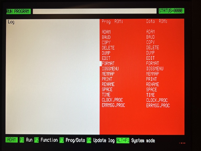

Just for the fun of it, it's not much use as you can't access 68K/OS MDV's, but this is 68K/OS running on MIST
Posts: 1217
Re: 68K/OS "ROM" based disk attempt
Just use the QL.rbf MIST Core, but replace the QL.rom with the one in the attached zip
