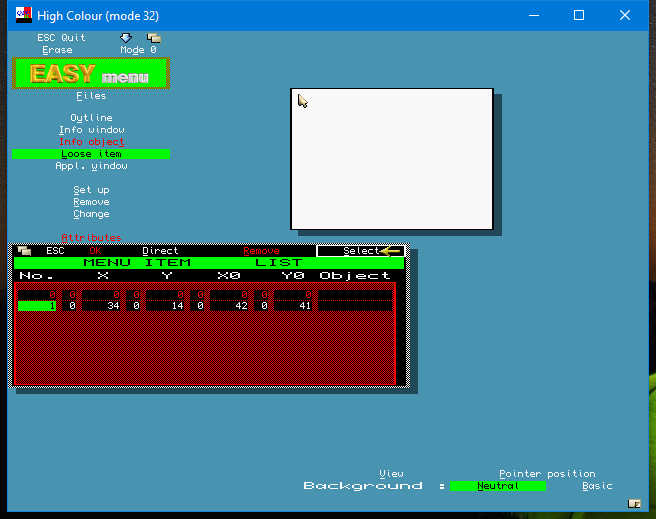

I am trying to learn to use EastPtr4, but I am hitting a few obstacles along the way.
First - If I create a new loose item Then set up the Underline and key. Then do the Text_input The 'e' of 'hello' is not underlined, and if I look at the menu item The underline and the key have been reset. And need to be redone again.
Is this a bug, or am I doing something wrong, or in the wrong order.
Re: EasyPtr4
Just the wrong order. Set the text first then the underlineMartin_Head wrote:<>

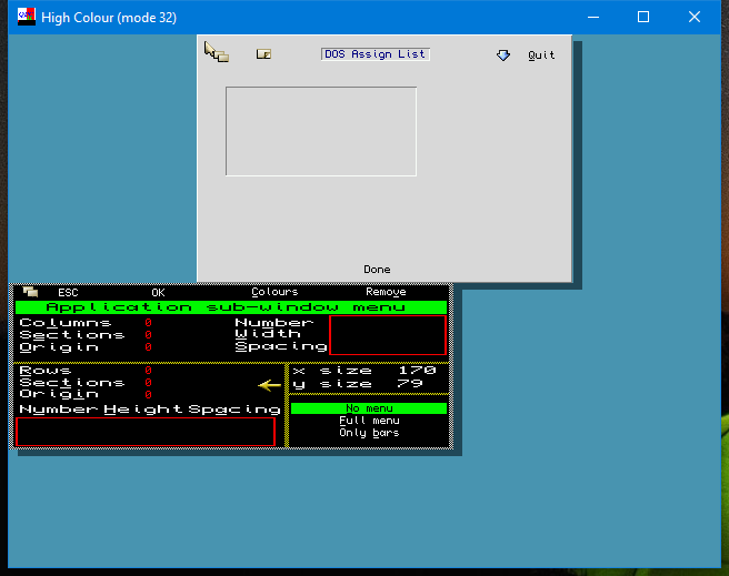

Second - I create a menu and set the Mode to 4
Note that the Application window has automatically added scroll bars, because the data does not fit.
If I reduce the window size, so the contents no longer fit horizontally I don't get the pan bars. And it falls over.
I played with this menu and got permanent scroll and pan bars to appear.

When I run it. It's not the same colour scheme
How do I change the way it's displayed.Note that the Application window has automatically added scroll bars, because the data does not fit.

I've been trying to use Norman Dunbar's tutorial for EasyPtr3. He sets the underline, the key, then the text_input. But he does not say that you have to go back and re-edit the loose item. I don't have a copy of EasyPtr3 to compare it with, that's why I thought it might be a bug. I did find a copy of EasyPtr1 on an old floppy disk. But that does the text input on a loose item differently.pjw wrote:Just the wrong order. Set the text first then the underlineMartin_Head wrote:<>

That's what I am trying to do. But what I can't seem to get to work. Is if the string is longer than the width of the application window, Then pan bars are added so you view the whole string. What I have read in the manual, If I understand it correctly, is that if the array does not fit in the application window, then scroll and pan bars are added automatically. Scroll bars get added, but the pan bars don't seem to be.dilwyn wrote:just using MAWDRAW keyword to draw a string array as a menu has always sufficed for me.
Am I doing something wrong, or can't you do that.

If array text runs longer than the AW widow you need to specify a column width that fits. The same goes for the height but that's unlikely to occur with text.Martin_Head wrote:That's what I am trying to do. But what I can't seem to get to work. Is if the string is longer than the width of the application window, Then pan bars are added so you view the whole string. What I have read in the manual, If I understand it correctly, is that if the array does not fit in the application window, then scroll and pan bars are added automatically. Scroll bars get added, but the pan bars don't seem to be.dilwyn wrote:just using MAWDRAW keyword to draw a string array as a menu has always sufficed for me.
The xsz%,ysz% parameters for MAWDRAW do just that. Text will be truncated at the column width. If the next column doesn't fit nothing from that column will be shown.
Take a look at SuQcess for a multi-column /-row example.
