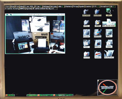

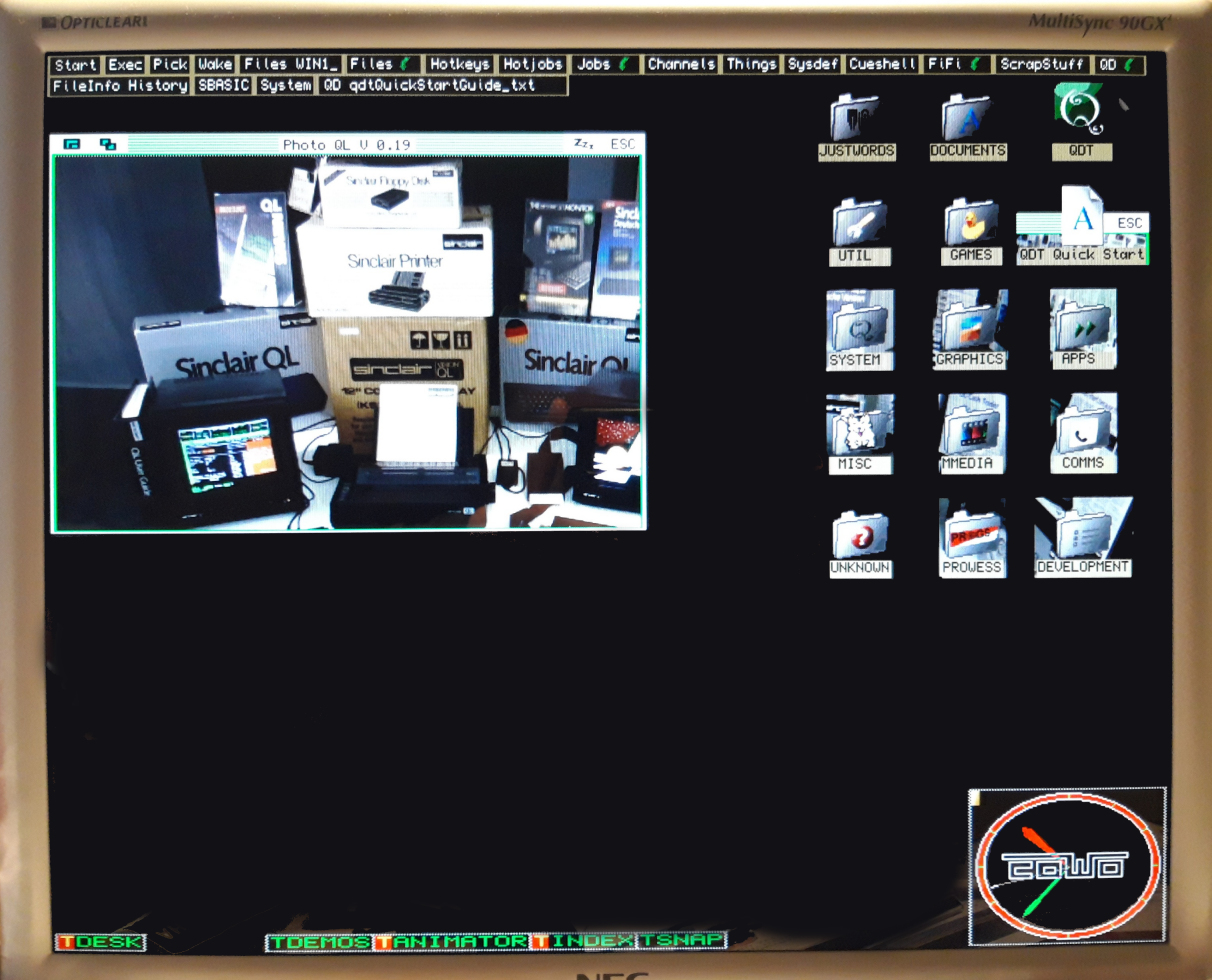

I got my QXL2 Card installed into a PC today then installed DOS/Win98 etc etc.
Then setup the QXL side of things to run QL/E (thanks Urs, remarkable the work that you put in to that). It is pretty slow, and as you can see, the area around the icons still shows elements of Urs QL collection image, before I resized it. But I suppose the slowness is to be expected with the CPU/RAM of the QXL2.

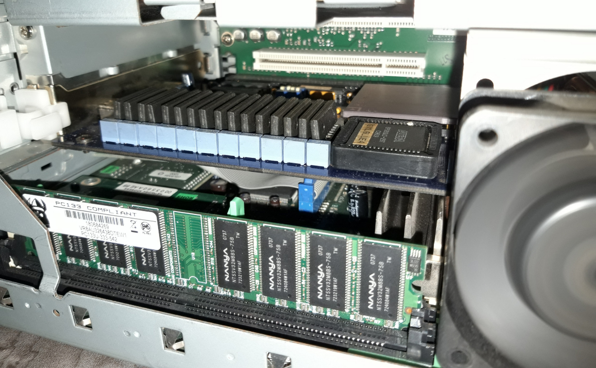

I just love the idea of the QXL. A computer in a computer, bonkers and genius at the same time. Here's the card in place:

Well, it's actually not so slow at all - What's slow is the transfer of graphics to the PC video card - Everything that goes to the screen needs to pass the ISA bus twice (try MODE 4 or generally something that needs a lot of CPU, but no video output and you'll see what I mean), from QXL to host memory, then to the video card.
