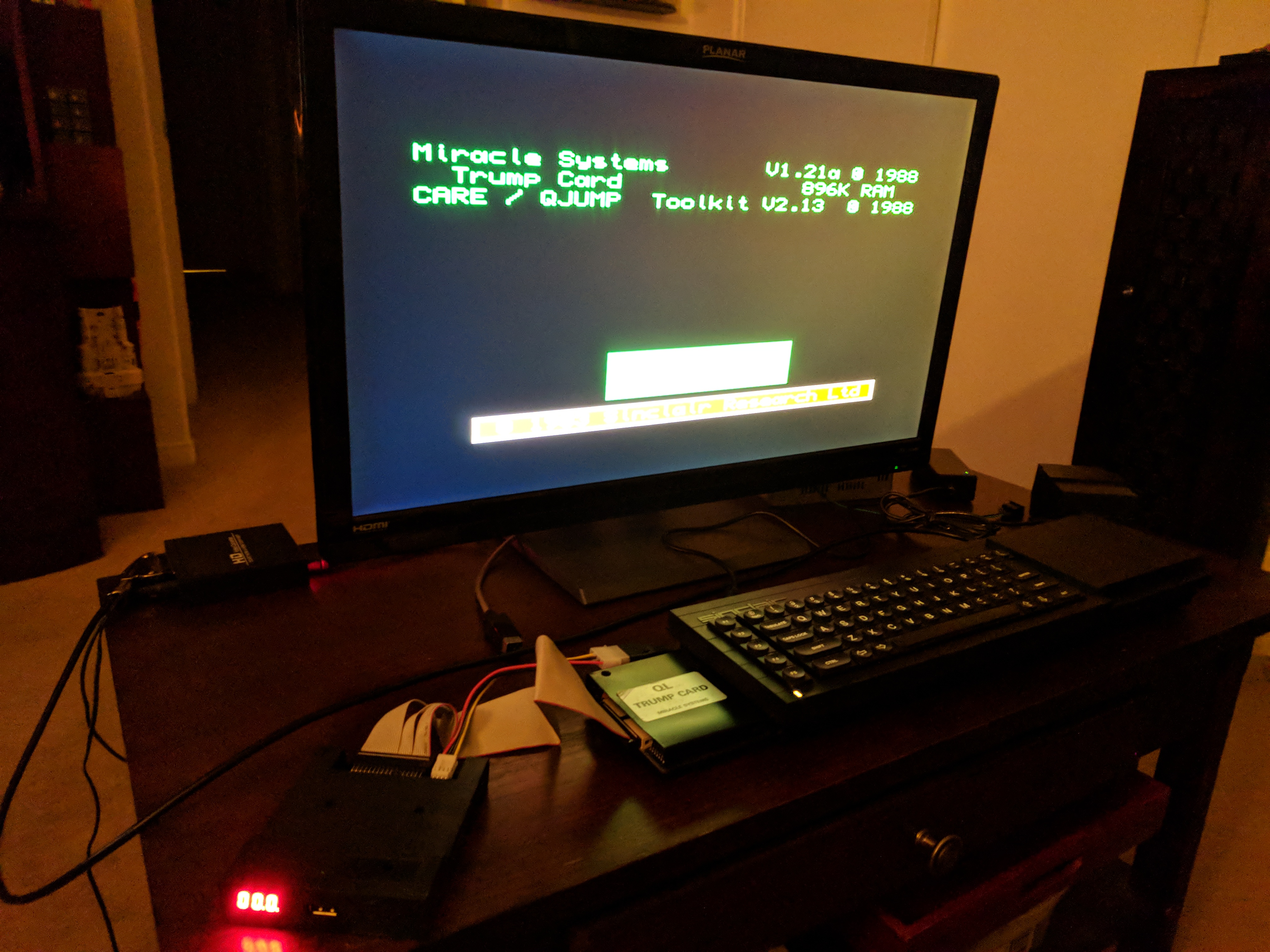

While I'm waiting for the keyboard mylar, I pieced together a SCART to HDMI setup. I have no idea if the Gotek will work yet.
Does anyone have an opinion about the Trump revision 1.2a? I have found a 1.36 revision on the web, and could update the rom if it is worth the trouble.
No idea whereCare/Qjump is, hopefully not in the same eprom as Trump 1.26, as that could complicate things.
