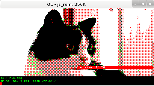

Thanksvanpeebles wrote:I just tried the cat one, that's really cleverHow does it work?
Anyway, it's nothing so special: an uncompressed _scr sequence is first loaded in Ram1, then displayed with LBYTES.
