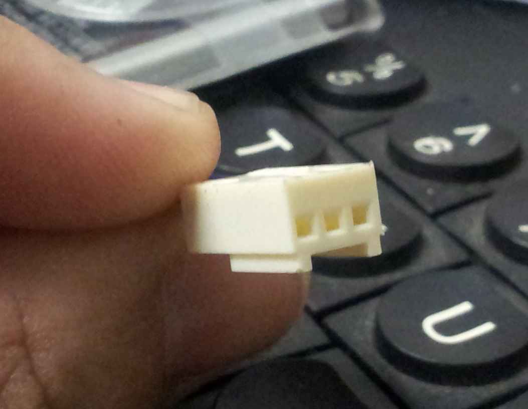

A very easy solution is to use a molex mini-kk (as it is called in Brazil, don't know about elsewhere) 3-pin female connector. I'm uploading an image, just a moment...Paul wrote:I am searching for a psu cord that goes into the QL.
Rich unfortunately has none for sale.
A non working or a working psu with cable on it would also do.
Has anyone a spare or broken he never managed to repair?
You just gotta file the top to fit in the QL power port profile
Hope that helps
