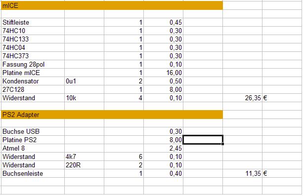

I put the component prices in the appendix, sorry its in german, but easy to identify the components.
I am strictly non commercial, but i want to have the money back. The most expensive part is the mICE pcb, from which i ordered 6, so i end up which 16 Euro each. Its in a very professionell quality.

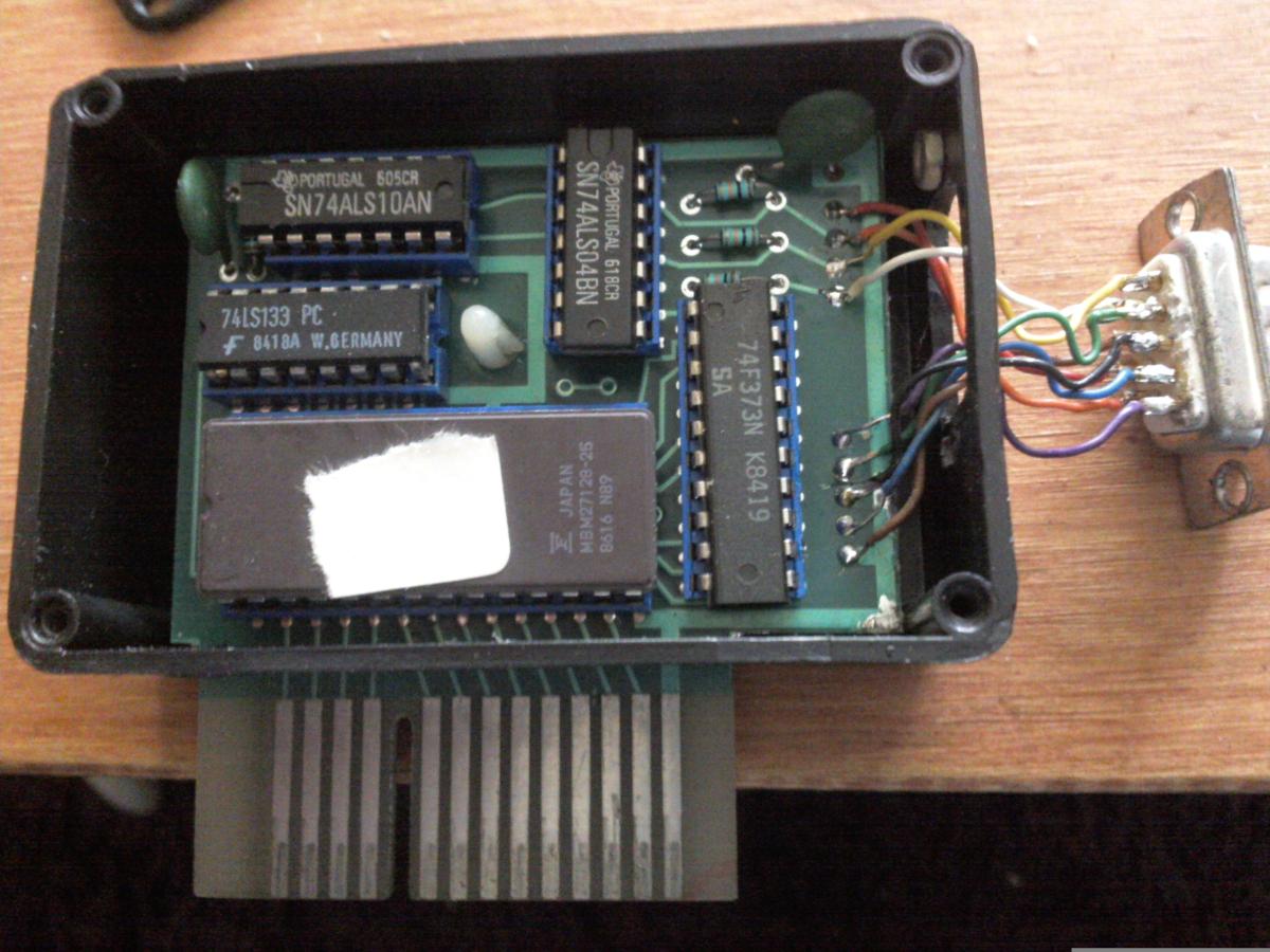

I notice in the PDF file describing the project, it is said, that Atari Mouse can not be used.
I have just found my old ICE Rom Dongle Unit, which I used many years ago on a Supergold Card QL, but the ICE Mouse got damaged and did not work. I rewired the mouse interface to accept an Atari Mouse, but this only had 2 buttons, but still allowed the ICR Rom Unit to work with Atari Mouse and probably Amiga Mouse, since there is a 2 lines differing from the Amiga and Atari Mice.
Here is a photograph of the Atari Mouse Connection, just a simple rewire of the ICE Mouse connection:
I have got the wiring connections details somewhere, which I will post when I find them.
